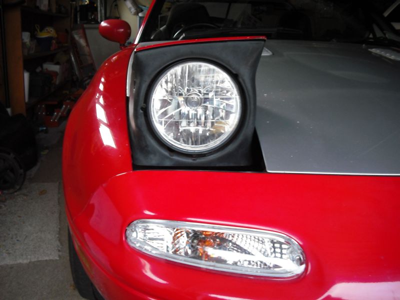

I run Raybrig's myself,Throw out heaps of light with standard H4 bulbs.

They (NA's)all came out with Sealed Beam head lights,Some Halogen some none Halogen,Halogen give better light,Of course when you blow a bulb you need to change the whole head light unit .
Semi Sealed means you can change just the bulbs ,put wanky ones in if you want,Even better light out put,Thats the one thing they do need at night,Better visibility for you and to been seen from other road users being as low as they are.
