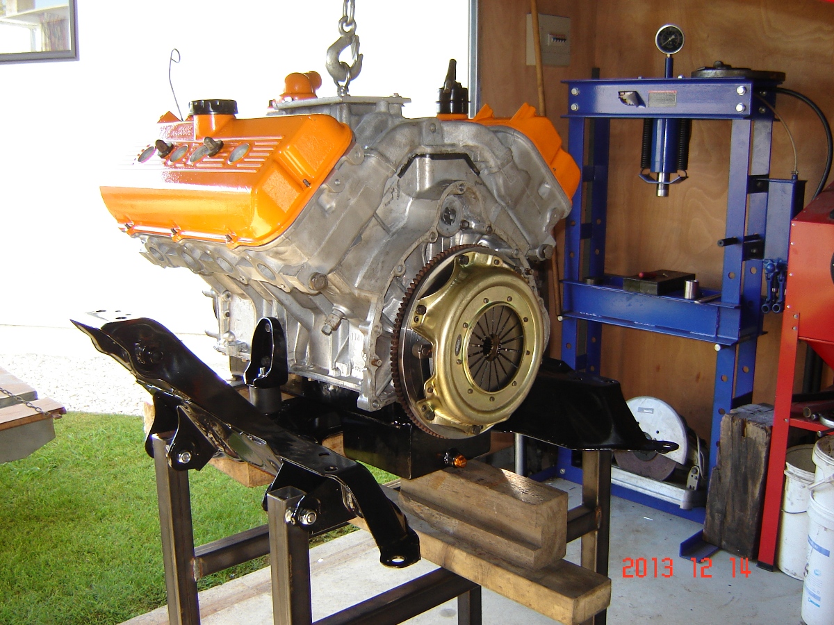

Post by Adrian » Fri Jan 03, 2014 3:27 pm
3.4 lt toyota hemi. Still lots to do but I'm getting there.

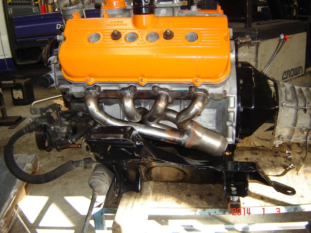

Post by Adrian » Fri Jan 03, 2014 3:29 pm
one more.

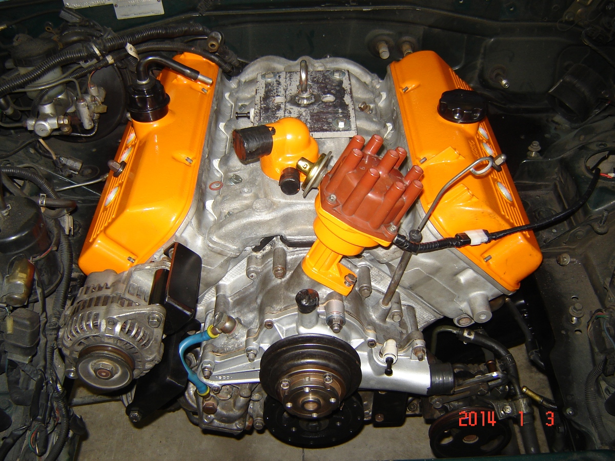

Post by Adrian » Fri Jan 03, 2014 3:36 pm
and another.
Post by CordedBowl » Fri Jan 03, 2014 3:57 pm
DANG.
Post by MrGrey » Fri Jan 03, 2014 4:03 pm
a work of art, tis a thing of beauty!
Post by SLYDIT » Fri Jan 03, 2014 4:26 pm
looks great!
make sure you hook up the power plant frame form the diff to the gearbox back up. its an integral part of the drivetrain.
