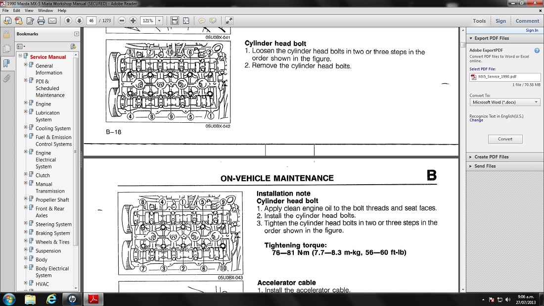

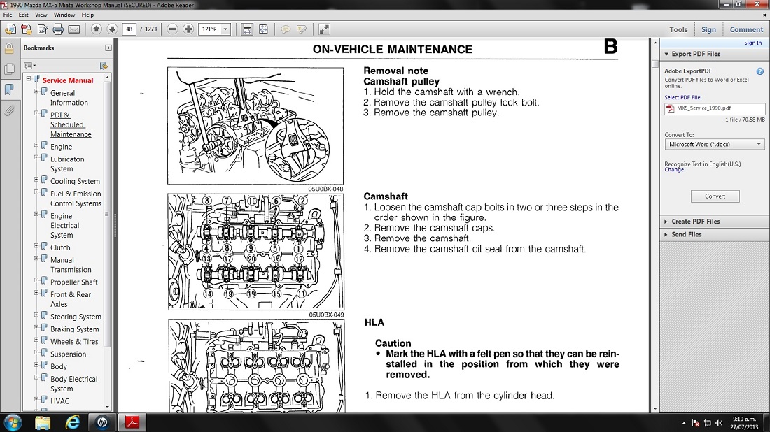

So she blew the head gasket on the way to work the other morning. Im going to take the head off and get it skimmed/cleaned/new seals.
Any instructions/manuals/torque rating info sheets or anything ese handy? Or any tips before I stuff something up?

Post by Furai » Sat Jul 27, 2013 2:56 pm
Cheers guys some great info!
