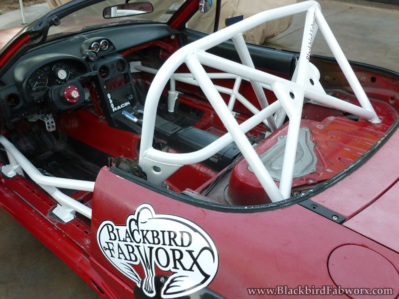

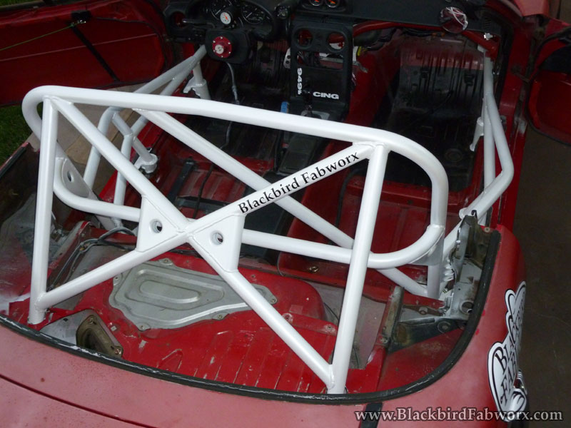

I was really interested in this particular design from Blackbird Fabworx in the US.
He has done a design that doesn't need gutting of the door (can't find that photo) but those will definitely need a change to bucket seats (a fiarly thin seat I assume).

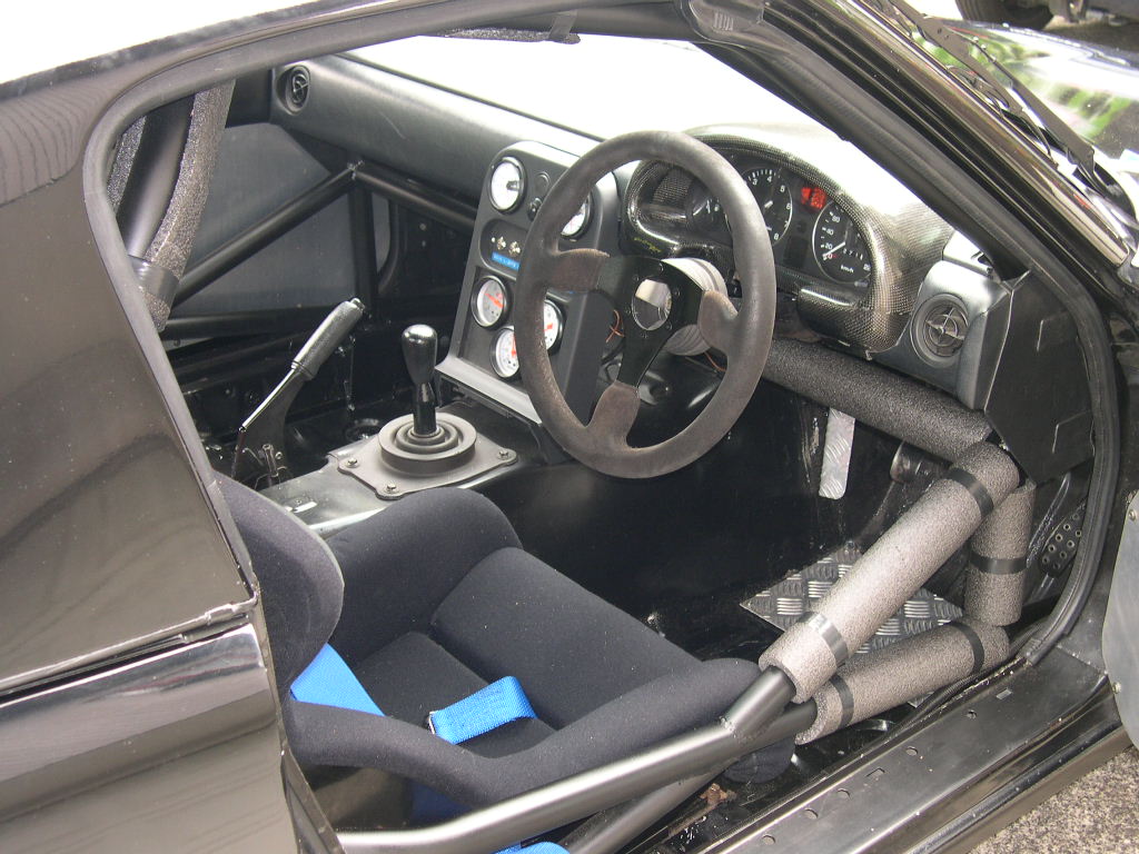

I used some stuff from Para Rubber on my car when it was both road legal and track only. It's only 12.5mm thick, and doesn't wrap fully round the bar, as you can see in the photo, but doesn't take up too much space either. I'm not sure whether the LVVTA rules specified >15mm thick when I got my certed (2004) but the MANZ scrutineers were always happy with it. Can't remember the cost, but it was much cheaper than the proper padding from Racetech or Cardwells etc. The OD is about 57mm and the ID 32mm.
