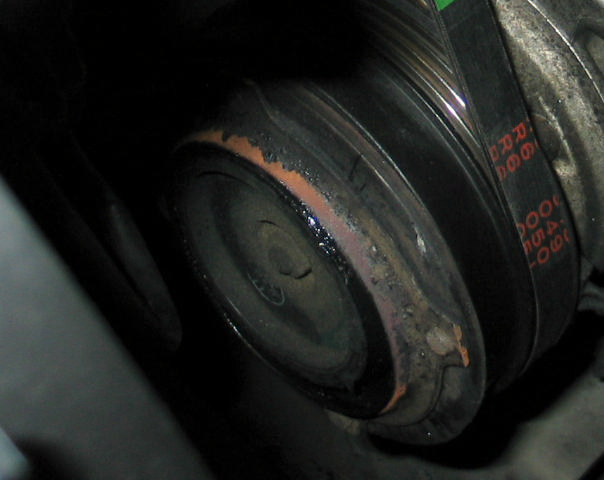

to me it's NOT looks ok. I had big smoke and some melted rubber like substance spraying in inside the engine room and mostly event on the back side of bonnet/hood. It was diagnosed it could be an accessory belt and both are changed. So, that was about month ago and I cleaned the black rubber as much as I can. So, I can see if that happens or if the is still some problem.
With new belt, I saw very small amount but still have this black thing under the bonnet. So I've looking very carefully and bet is OK, but find the front of air conditioner compressor is not sleight. Touching there has this sticky , a black staff that is exactly same as one I found under the bonnet.
Is this means the compressor is totally out or just a seal and refilling the refrigerant and so on?
AC is quite handy to tale hot are out and so on, but I can live without of that cost too much in that case maybe take whole things out...
Appreciate advise or even the photo of your air conditioning compressor will be helpful.

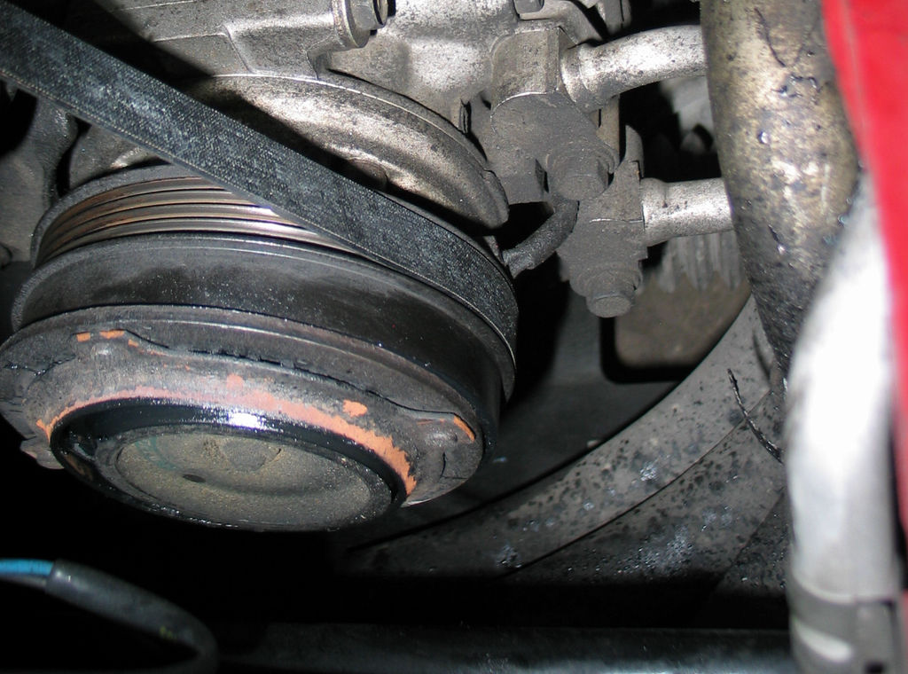

Close up in slightly different angle. I can not stick my Canon G3 to take a good pic...

It would appear that your problem may be confined to the clutch, rather than the compressor proper. It is impossible to tell without being able to actually examine things. You will have to ask someone who knows their stuff, to physically check it for you.

My car is actually running fine but I'm bit worried and wondering about what is the black rubbery (more like tar) looking staff in front (inside) of the compressor pulley .
Any input is appreciated.

Yes, I mean the magnetic clutch. The clutch could contain a friction material which could be slipping, overheating and giving off the stuff you describe.

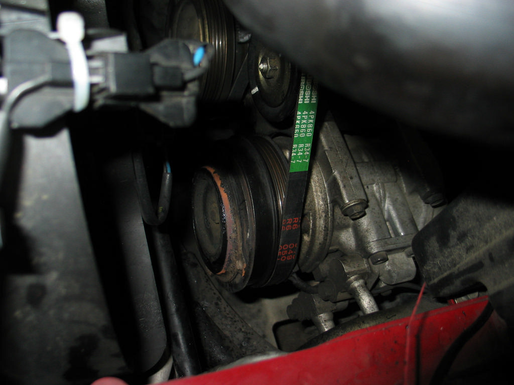

I took another pic that more clearly show how it is not aligned from centre. and place at the back
It's not centre and black rubber like staff splatting in surrounding.

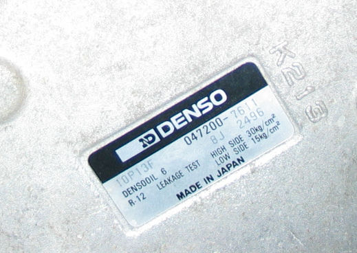

Model number place at back

New AC comp in and recharged the gas. I think the AC guy converted to R134 gas but no sticker label that indicating the conversion.
