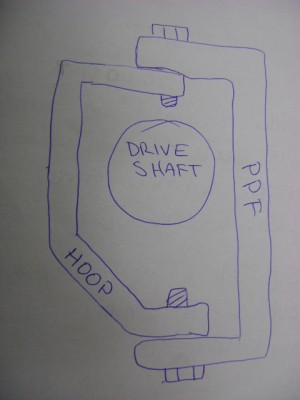

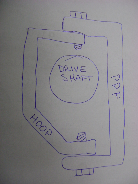

Having read the technical documents on the lvvta webpage I think that the car is well prepared for the cert with the exception of a driveshaft hoop. Can anyone tell me if the PPF is likely to cause problems with fitting a hoop?

i just used a length of 50X5mm strap and bolt it arround the drive shaft to the top and bottom of the PPF about 100mm from the front universal

sprsta: Do you mean you bent a piece of 50x5mm bar into a U shape and bolted that to the PPF or am I misunderstanding you?
That certainly sounds like an easy way to do it.
Post by sprsta » Wed Jun 01, 2011 2:00 pm
like this

Post by RMS » Thu Jun 02, 2011 8:17 am
Thanks, I was understanding you correctly then.
actually looks a lot simpler than the hoops that bolt to the chassis.
Did you have to remove the PPF to drill the holes?
Post by sprsta » Thu Jun 02, 2011 4:42 pm
Nah, i think i had the drive shaft out though

Post by RMS » Mon Jun 13, 2011 10:05 am
Got it sorted, I had mine go around the outside of the PPF but it's basically the same :)
Was a real pain drilling the top of the PPF though, luckily the previous owner of my shed was a mechanic and there's a ramp outside that provides access to the underside of the car and also had to take the drive shaft out.

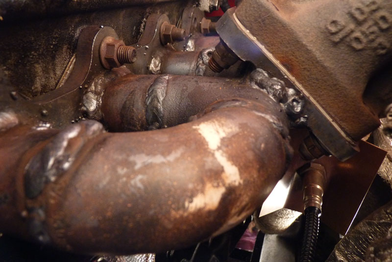

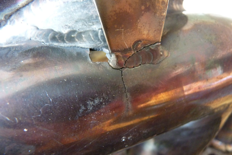

<500km and my cheap trademe manifold has cracked, didn't think I'd have to build my steam pipe manifold _quite_ this soon.
Post by sprsta » Tue Jun 28, 2011 8:19 pm
Tisk Tisk Tisk
The old do it twice do it right story eh?
Those stainless things arent even worth the postage

Built a new steampipe manifold over the weekend using autobend flanges... she's not pretty but it got me home :)
The 'ebay' manifold doesn't just have a crack in it, it's actually had a piece fall right out. hate to think that that would have done if it went through the turbine.
