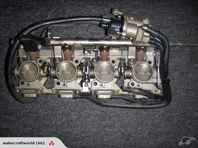

Post by Kieran » Fri Mar 25, 2011 2:37 pm

Depends how much you want to dick around, and how much you want to spend. When I priced getting a manifold fabricated for a set of AE111 (Toyota) ITBs, the estimate was around $900 - $1000. Jenvey are now doing an off the shelf kit for the BP4W head for GBP611. (About NZD1300).
http://www.jenvey.co.uk/home/standard-k ... it-ckmmz01
There are a couple of other items required like a vacuum manifold, throttle linkage and TPS but they don't add a lot more to the price.
The other thing to remember is that you will require an aftermarket computer to drive them properly.

I would say find out what diameter will suit you best. There is calculators online for working out intake diameter/lengths for what power/rpm you are after.
Getting a manifold made up may not be to much of an issue if the throttle seperation is similar to the port spacing. It is possible to cut up a stock manifold and weld a flange on, or if using the bike carbs use the rubber sleeve things.
I remember someone was selling a set of cbr 600 (?) throttles with manifold for $250 a year or so back

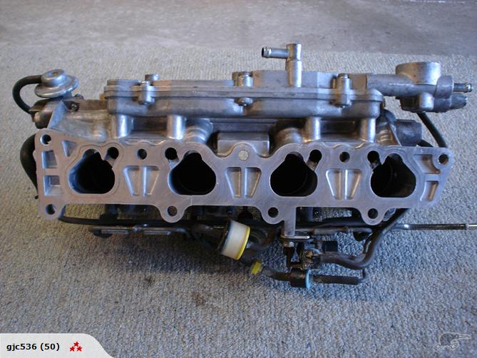

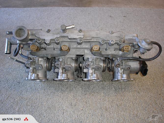

Post by Angreal » Mon Aug 08, 2011 9:16 pm
Just wondering if this would be worth sticking onto my car or will it just cause me problems/make the car worse?
http://www.trademe.co.nz/motors/car-par ... 106500.htm
Post by Euen » Mon Aug 08, 2011 10:04 pm
Hard to say. The runners look pretty short and the flares on the "trumpets" don't look that great. Probably more suitable for a forced induction set-up.
