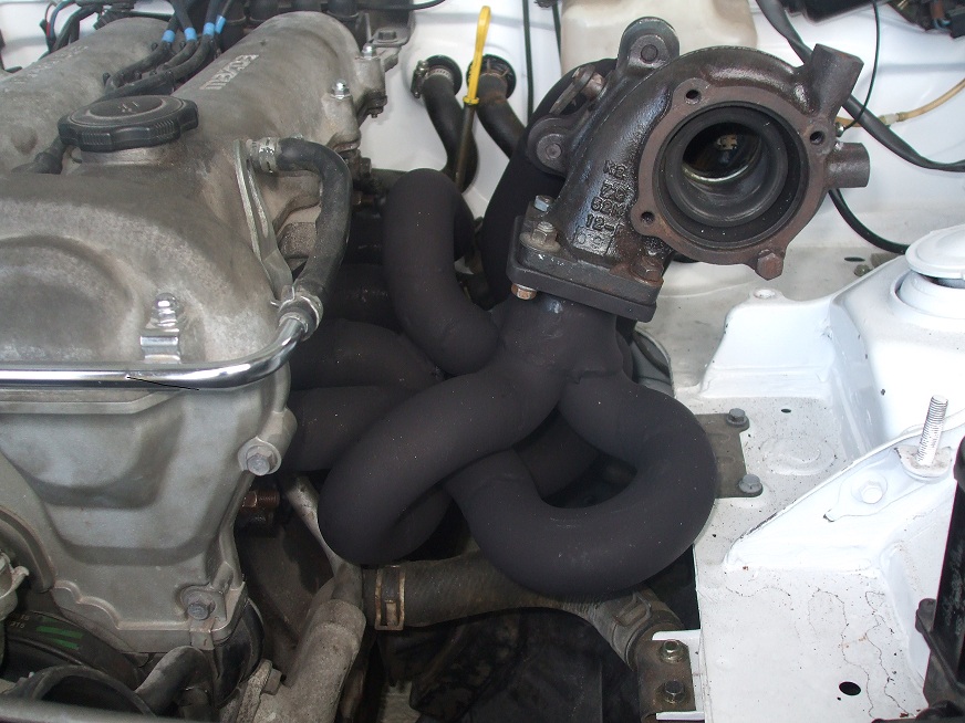

Post by WideOpenThrottle » Mon Jun 25, 2012 8:39 pm
authentic wrote:I did think about going local for sure. I just went searching for headers and came across those systems which seemed pretty sweet.
Would an exhaust shop be able to source headers, or would it be best to get some myself and take them in?
This is the sort of thing the local guys can do!...i have no complaints
Custom headers
That looks sick, definitely wouldn't have any complaints with that!

Post by WideOpenThrottle » Mon Jun 25, 2012 9:06 pm
Thanks authentic...headers,dump-pipe,coby,sport muffler & 2.5" pipework fab'd & fitted for a grand from a crowd in Hillside Rd Glenfield [couple a years ago].
