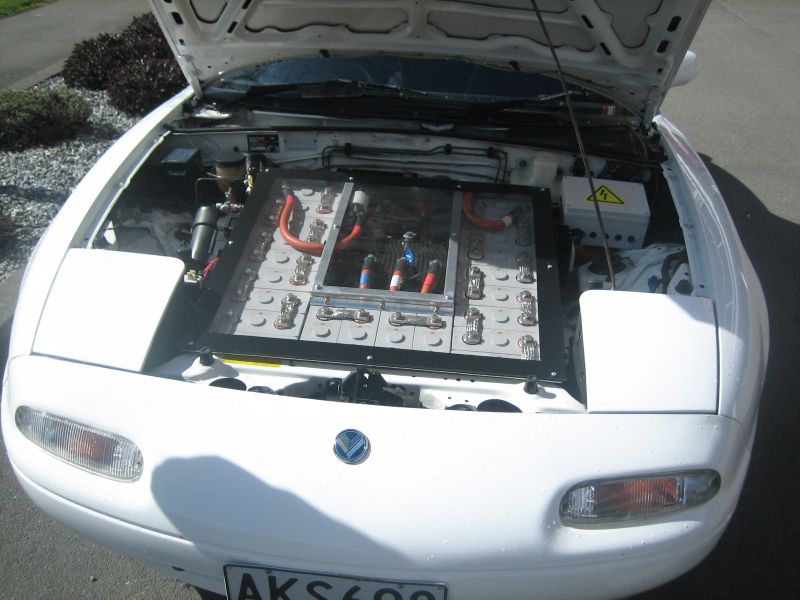

Engine Bay - Hmmm I don't seem to be able to upload images. You will just have to take my word for it
Post by brownie » Sun Sep 15, 2013 11:08 pm
Take his word for it,VERY COOL,seen in the flesh myself,i will upload a couple of pic's we took at work when John called in,

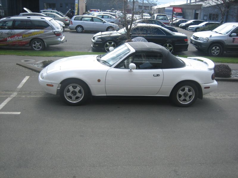

Post by mazline » Tue Sep 17, 2013 5:22 pm
photo's of the car
Post by Furai » Tue Sep 17, 2013 5:33 pm
Wow thats different! We were just talking about this on Facebook actually...
Whats performance like? Range and speed?
Post by MrGrey » Tue Sep 17, 2013 7:07 pm
that is seriously awesome!

The torque is 100Nm from 0 to 4200rpm, then it tapers off. Which is different from the curve around 5000 rpm with the original engine. The power is 74kW.
What this means is that it is quite different to drive as you have full torque from when the motor is stopped. I don't need to use the clutch to start or stop. It will pull away from completely stopped in 5th gear. You can drive it like a conventional car using all the gears and the acceleration will be better than standard. Alternatively I have found 3rd gear is really good around town and I just leave it there unless I am in a hurry. 5th gear is great on the open road.
Currently the range is about 130km on a charge with a 50/50 mix of town and open road. This still leaves another 20% reserve in the batteries. The cost do travel this distance is about $3.50 in electricity. There is an exemption for road user charges foe electric vehicles until 2020, so there are no other costs.
Charging from my wall socket will take about 7 hours overnight. The batteries are capable of being fully charged in 20 minutes, I just don't have a power source capable of doing it at home. Realistically it can't really travel city to city. But is ideal for someone with a long commute.
You would be absolutely amazed how good the electric motor performs compared to petrol. The torque is always there and they are so silent and smooth. The motor is tiny as well only 225mm diameter and 350mm long with roller bearings at each end and no wearing parts.
Post by tomtikki » Wed Sep 18, 2013 9:34 am
I absolutely love the idea of an electric car!
Yours has an almost factory finish under the bonnet, well done.
No doubt quite satisfying to drive about.
I very rarely travel more than 130km in a day but if I did (at my current mileage rate) it would cost me $23...
I'm sure you get peppered with questions about it all the time but it is a very exciting prospect as fuel prices will only ever go up!
I assume you still have wof & rego, what about a electric cert like what camper vans need for 240v hook up? -Ive heard about them but dunno what it is?
I guess the biggest argument against is battery lifespan/replacement and disposal, yours look brand new so what can you expect out of them?
