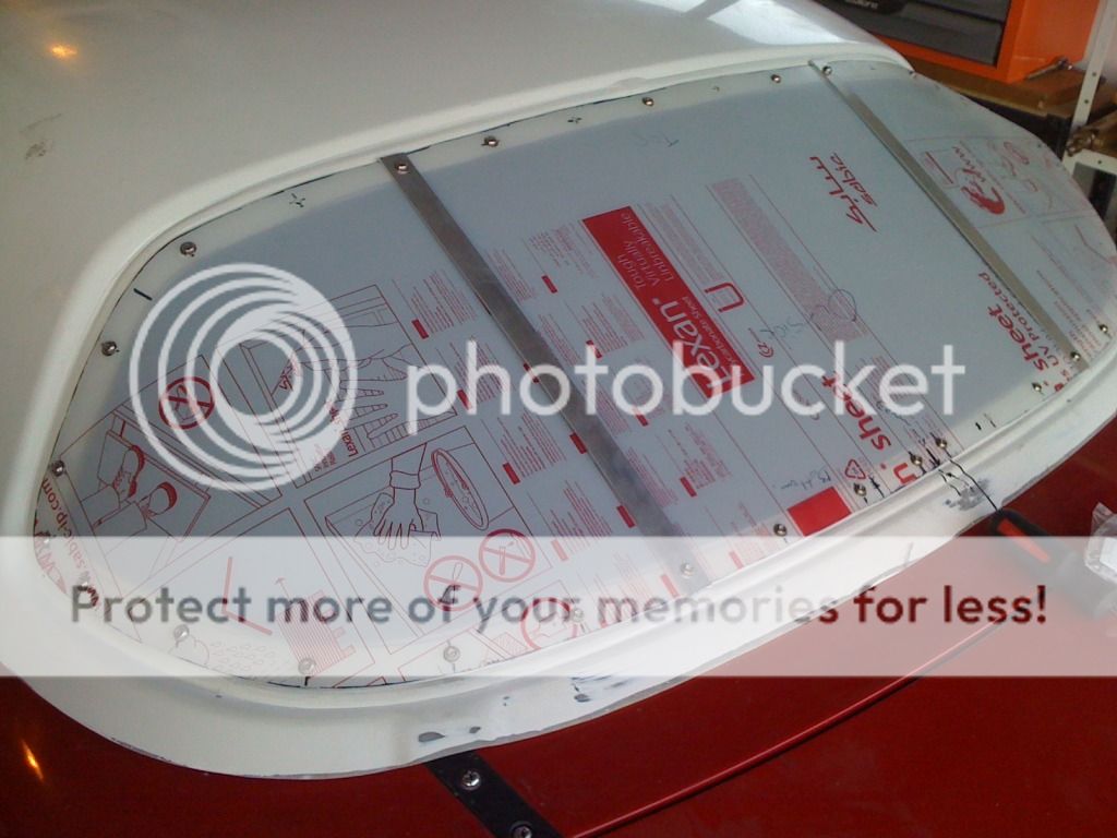

Quick shot of the Completed interior paint
Used my awesome rubbish sack template to cut out the rear screen from a sheet of lexan.
started to bolt it on
Used every M6 nut and bolt I could find in my garage to bolt it all down and wrap the sheet around the curve
Really happy with how this has come out, should look really good when done.
Post by Furai » Wed Jul 04, 2012 11:40 am
Nice,, are you gonna cover up the bolts or go countersunk?
Post by punkoutnz » Wed Jul 04, 2012 12:12 pm
Some nice chrome cap bolts would look really nice. Bloody mint job on the hard top dude!
last_resort14
Posts: 252
Post by last_resort14 » Wed Jul 04, 2012 2:23 pm
Countersunk can make it more likely to crack etc, so will be going with some stainless done head cap screws or something like that.

Post by Growler » Wed Jul 04, 2012 5:05 pm
I thought 6mm would be overkill to hold the acrylic/polycarbonate down - especially if you are looking to save weight.
Polycarbonate is very strong and is highly unlikely to crack like Acrylic (Perspex).
I have used 3.0mm PETG Sheet (Same family of materials as Coke bottles) for the side windows of the race car and that is held down by 3mm countersunk setscrews.
The front screen is flame hardened Polycarbonate (So it doesn't scratch) and that is held down by the same size 3mm screws.
Just my 2 cents worth...
Post by Angreal » Wed Jul 04, 2012 5:06 pm
Rivets are a possible option also?
Post by Snapfrozen » Wed Jul 04, 2012 7:18 pm
Quick question. If you want to run the car on the road, it MUST be Lexan correct? So in relation to a hard top, you could just take the top off and go for a cert? Sounds perfect!
Post by Growler » Wed Jul 04, 2012 7:19 pm
Angreal wrote:Rivets are a possible option also?
They are...however if you wanted to take the window out for painting, repairs etc at some point, you have to drill the rivet heads off which can damage the surrounding area.
last_resort14
Posts: 252
Post by last_resort14 » Wed Jul 04, 2012 10:56 pm
Yea the 6mm bolts are probably overkill, not really worried about weight though, and the holes are drilled now, so no going back :D
To be street legal it has to be lexan MR10 or the equivalent from another manufacturer, and at least 5mm thick(from memory)
Mines only 3mm thick, and only the lower grade lexan, the MR10 stuff was about 4 times the price.
I also Have to put 2 metal straps on the outside of this window, minimum of 25x3mm, so will put these on using some of the 6mm bolts

Got my stainless fasteners, washers and nuts etc, threw a few of them on there to see how it will look, also got some 25x3 alloy bar for the straps on the exterior as required by msnz.
