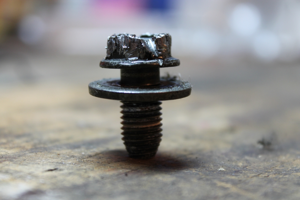

Anyway today i managed to get the rounded seat bolt out and was able to do a foamectomy.
Removed the foam bump/bucket off the bottom of the seat and removed the pad in the back of the seat.
Now have ~50mm of head room instead of me being able to sit up and have my head touching the roof.
Best mod ever!
Post by MrGrey » Tue Feb 12, 2013 8:46 pm
grats on getting that troublesome bolt out, it sounds like it was a complete bastard......
Post by siren676 » Tue Feb 12, 2013 8:57 pm
It had to be well and truly butchered to get out. Didnt help that it was the hardest to reach bolt and looks like it had loctite on it
Post by MrGrey » Wed Feb 13, 2013 12:23 am
yeah, that yellow'ish residue looks like ancient loctite. at least the little sucker is out now.

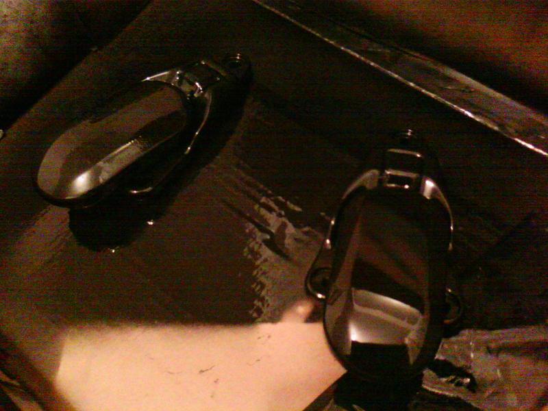

I have spent the last few hours sanding and painting my hardtop latches in my painters booth (some people call it a bathroom, but, whatever) and I was amazed how pitted with corrosion they were.
pity I didn't take a pic showing how bad they were, but heres the (drying) finished product...
Post by Snapfrozen » Wed Feb 13, 2013 7:37 am
Did you have trouble undoing the screws holding them in? Mine are all rounded...
Easy out time?
Post by chris » Wed Feb 13, 2013 8:16 am
Those hardtop latches came out really nicely! Never even thought of that!
Lowered my car another 15mm all round
Post by MrGrey » Wed Feb 13, 2013 9:17 am
They came out quite easily Snapfrozen, seems like some idiot has tried to use an inappropriately sized tool to try and get yours off. :cry:
Post by chris » Wed Feb 13, 2013 9:28 am
MrGrey wrote:They came out quite easily Snapfrozen, seems like some idiot has tried to use an inappropriately sized tool to try and get yours off. :cry:
Mine are the same :'( I might take them off tonight as it is soft top/no top weather ;)
Post by MrGrey » Wed Feb 13, 2013 10:44 am
here's a little more info for those considering giving their latches a birthday.
I used a 180 grit wet and dry sandpaper to prep the latches for painting, I initially thought it would be too course but it turned out to be just right. The pitting took quite a while to sand down and I was surprised how corroded mine where but that is to be expected considering its age.
Remember to pop a bit of masking tape over the release button after you have washed the latch with meths/alcohol, prior to painting.
I used 2 coats of satin black and 2 coats of clear acrylic and they look almost brand new. Ensure you give it adequate drying time, it sucks to get finger prints on your hard work.
-=edit=-
please bear in mind my tablets camera is shite... the previously attached photo doesn't really do them justice.
