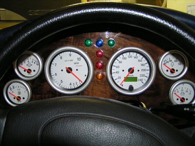

You could always look at these if you are going aftermarket. The tacho and speedo come in 80mm and 100mm diameters.
http://www.caigauge.com/page36.html
I used the 80mm version.
