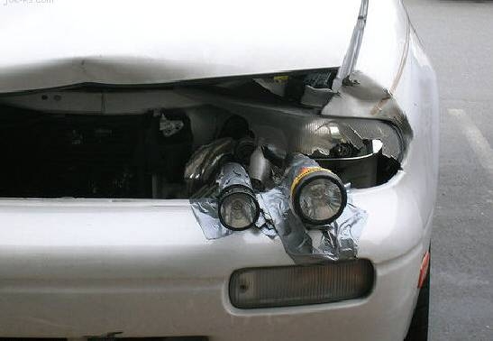

Post by Euen » Wed Sep 22, 2010 9:22 am
I guess you could always try something like this.
Post by sprsta » Wed Sep 22, 2010 7:41 pm
i had a bluebird just like that one.
i think i paid less for a second hand headlight than those two torches would have cost
Post by Donovan » Wed Sep 22, 2010 10:06 pm
Hmmm, think I might need something that lights up the road a bit better
Post by Timmo » Thu Sep 23, 2010 9:45 pm
Donovan wrote:Hmmm, think I might need something that lights up the road a bit better
3 torches? :lol:
Post by Donovan » Thu Sep 23, 2010 9:47 pm
Yeah, that should do, maybe those LED ones, so it looks like an expensive euro car
