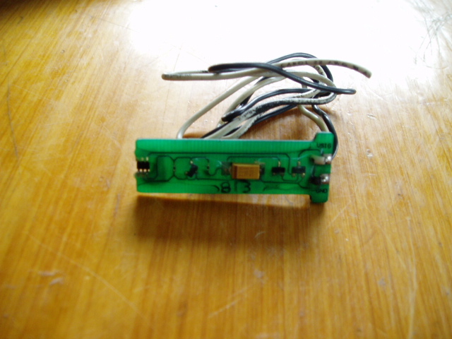

Ok thanks Cole. I spoke to Simon at link yesterday.If possible I would like to know the wiring changes and a price on the part as I didn't get that far.Were you still after the FM air temp sensor? I am going to sell mine.
