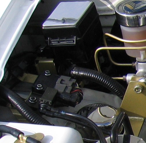

I have read elsewhere that there is an 'Igniter' or 'Ignition Control Module' that sends a signal to the coil packs and that it is located near the interior fusebox, but I can't find it. Apparently, this can fail and the coils won't trigger, but on initial start up the 'Igniter' is bypassed, hence the fact that it starts for a few second. Also, if this thing fails there is no signal to the tacho. That's exactly the symptoms I have, if only I could locate the darned thing, I have some test readings from a good one (off the internet) to compare with mine.
I've seen a picture of one in a Mazda spares Internet site, so I know what it looks like. It's a flattish black plastic gizmo a bit smaller than a cigarette pack but thinner.
If anyone can point me in the direction of that thing I would be grateful, then I could test it against the readings I have.

However, my car definitely does not have an igniter in that location. In between the fuse box and that little emission thingy with the vac pipes on it, there is just an empty bracket with two (screw) holes in it. Presumably this is where an igniter would fit but I think my model has one in a different place, or maybe it is built in to something else.
