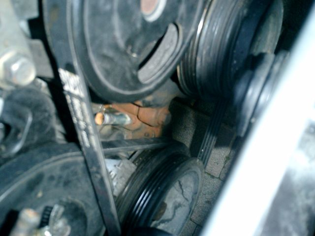

A pic is worth a 1000 words... here is when it happened to mine. (although this crappy pic is probably only worth 50 or so...)
This shows the pipe - disconnected.
I did a temporary repair (6 months or more from memory...) by breaking off the elbow at the bend and just putting the hose on with a hose clamp. Happened at Taupo track a few years ago.
I got Don (Autoway Services in Hamilton) to fix it when it was there one day.
As Slydit said I think the elbow is replaceable with minimal work. Seems to be quite a common issue.

The hole in mine was right on outside of the bend - it had corroded through.
Is there enough tube left for a temporary connection with a hose clamp? It will at least get you moving again.
Hopefully your engine bay looks nicer than mine in that photo?!
