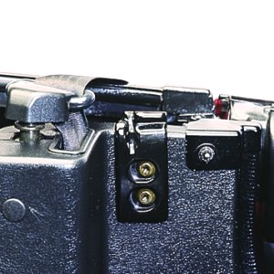

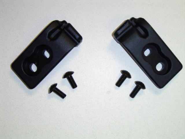

Some pictures gleened from the internet are below, showing the fitting kits which include side latches and bolts, and the frankenstein bolts.
Please add your other comments or experiences (including photos) below.
Side latch kit with fitting bolts
A fitted side latch.
One side latch with bolts, and a frankenstein bolt

I tried to load link to car domain for fitting striker plates but it will not load. Is there indentations on rear of plastic trim where the striker plates mount. Do I remove the plastic and drill bolt mounting holes or is there another technique. I have a English/Japanese fitting instruction but the pics are a bit blurry to see clearly. Does,anyone have a clear set of instructions or a good link or some constructive advice. Can i fit frankenstein bolts and then fit hardtop and position strikers with reference to where the clips sit??? Thanks. Appreciate your help.
Post by brownie » Wed Sep 11, 2013 8:59 pm
Black inner plastic trims beside the seatbelts?...
Yes ,whip them out and you will see 2 ovals you need to cut out to mount the striker mounts
Hardtop strikers
Post by GRUVBB » Wed Sep 11, 2013 9:09 pm
Awesome Brownie. Thanks for confirmation. Plus 1 for you.
Post by Timmo » Thu Sep 12, 2013 11:39 am
In my case, due to my roll bar install, I couldn't remove the plastic side trim completely, but removal of the metal top trim which sits at the meeting place of the door and frame allowed me to pull the side plastic and seatbelt tower plastic out slightly to verify where the bolt holes were (although I also marked the outline of the latch in pencil with the hard top on as well- this was also sufficient to get the first drill hole in approximately the right place)
I then drilled though the plastic and then using a sharp stanley knife trimmed out the holes so the side latched sat in the correct place.
