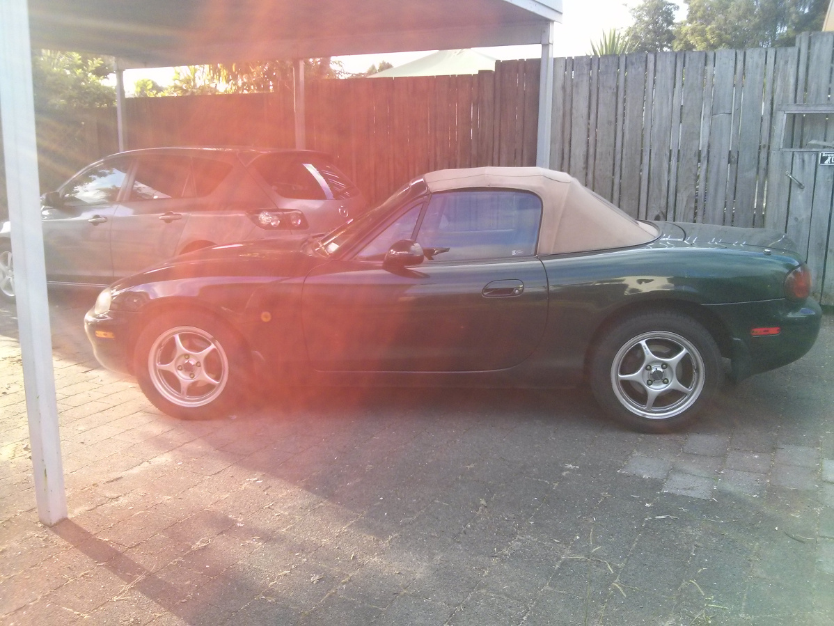

Post by dkbuchanan » Tue Feb 10, 2015 10:27 pm
Well I've gone and bought a set of Enkei RP01s 15x6.5 which as far as I can tell (there isn't much information on the interwebs, too old I think) they should be lighter than the factory JellyBean wheels at 5.8kg each, which is still heavy compared to RPF1s but they are well out of my budget.
We shall see how these go.
