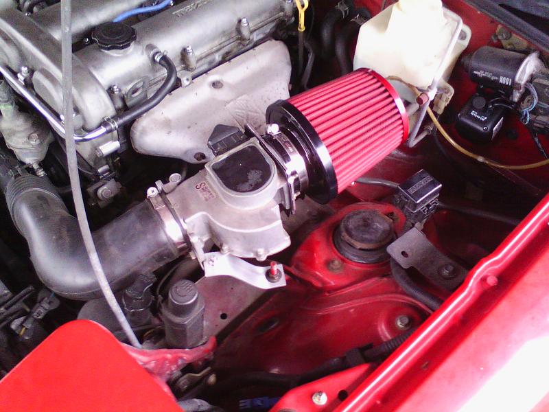

I received the filter adapter today and it fits perfectly, but I did notice some small flecks of alloy on the rubber gasket so I took a little time to sand the edges and clean it before installation (I don't want any fine pieces of crap going into the engine)

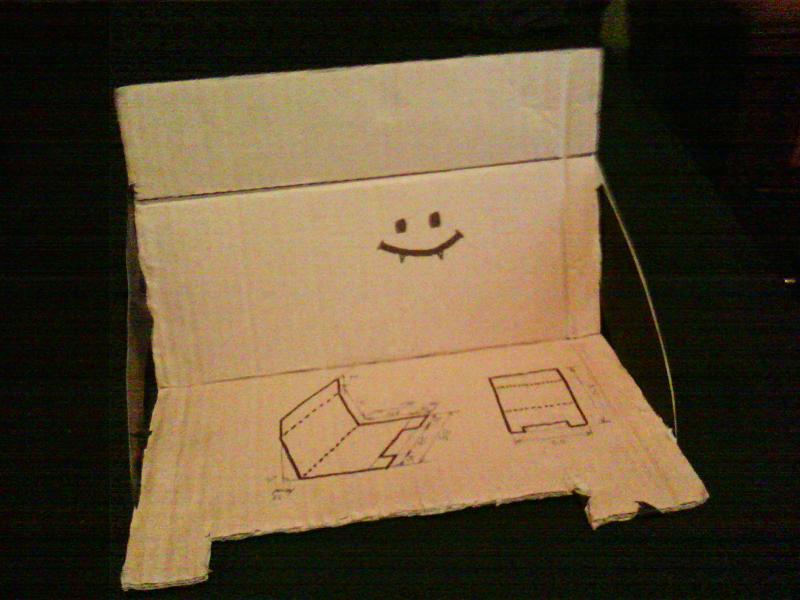

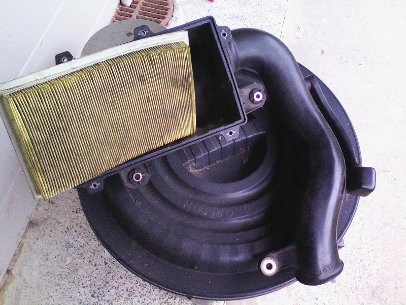

Installation went smooth and I was surprised how filthy my old filter was. I have made 2 braces to support the filter (I made a second much larger brace after the picture was taken) and now only have to get the heat shield made. I have made a template that I will give to an engineer friend of mine to fabricate. I will probably have the first prototype made of thin sheet steel and paint the engine side with a heat reflective white engine paint whilst painting the pod side with a heat resistant matt black. The tricky bit is going to be mounting it and adding some small braces to it to eliminate vibration.

my heat shield template. hopefully it will only require minor alteration to fit.
the thing that goes sucky sucky
my dirty filthy dusty filter and airbox.

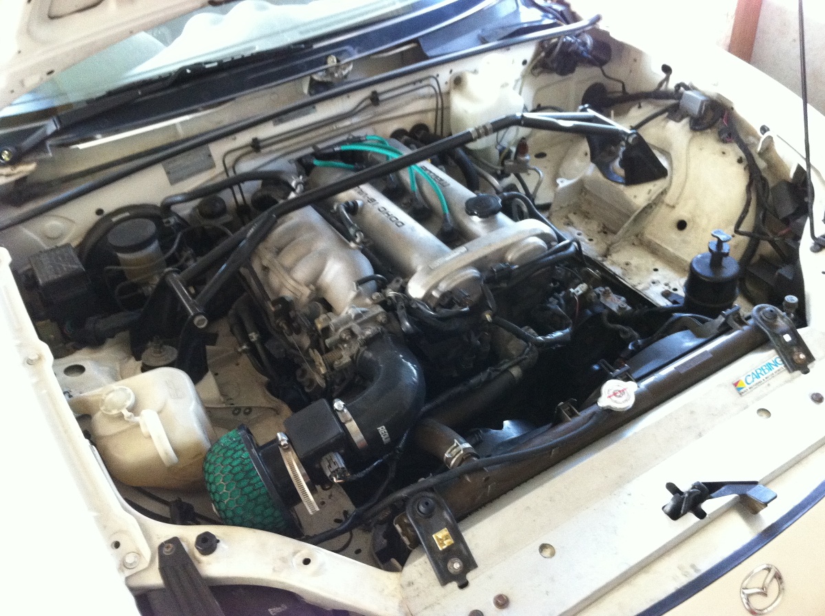

I'll pop up a picture of my pod filter, seems to have an Apexi heatshield too. (I'm probably wrong)
As for the whole power gain/loss thing meh, its only at the most 2-3 HP we're talking about here. Are you really driving your car hard enough to shave that half a second off reaching the finish?
The sound is worth it imo :D
