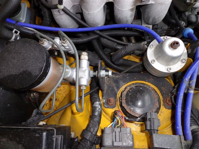

Excuse the messy engine bay, but I have one that you are welcome to borrow to try. If all goes well, there should be a photograph attached to this post.

ive been thinking of making something like the above by drilling a hole in my strut brace, would take like 10 mins to do, but i also thought i would want to re-inforce it to make it stiffer.
the one in that above photo i dont think would do anything, looks way to flimsy.

For everyone out there considering a brace.... i am just working a design similar to DBM's one, with an added support rod from the bolt to the forward mounting point.
i could whip up a batch of them if anyone is interested.

Post by DBM58 » Sat Nov 03, 2012 2:31 pm
A fair point about it being flimsy. However, and I am not an engineer, but it is made from 6 steel with a welded on support plate in the corner to prevent any flexing. I appears to have no movement when I try to bend it, and the same when I watch it when someone else presses the brake pedal. But you may be right and I am just not seeing it.
David
last_resort14
Posts: 252
Post by last_resort14 » Sat Nov 03, 2012 3:44 pm
I stand corrected :oops:
Hadnt noticed the triangular corner re-inforcement you have on there, which would obviously do the trick and make it solid as.
