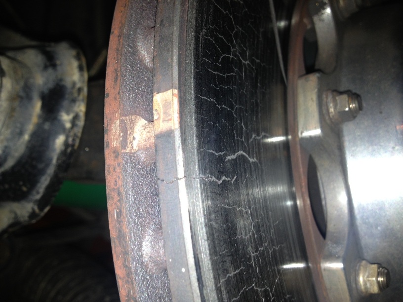

Post by Donovan » Thu Oct 18, 2012 9:52 pm
bit of a routine check of brakes and rotors this evening and stumbled across this. Have seen hundreds of heat cracks in my rotors, thought they were small fractures that didn't go very deep, guess I was wrong.
Post by Angreal » Thu Oct 18, 2012 11:07 pm
These are the kangaroo paw rotors right? The ones that are said to have really good cooling properties on the Goodwin website?
Looks pretty serious to me should your rotor fail coming down a main straight...
Post by Donovan » Fri Oct 19, 2012 1:07 am
Yeah, it's the DBA's from Goodwins, guess the cooling properties weren't all they cracked up to be.
Not going to be doing anymore track days till I get a new set, now will just have to figure out what sort of rotors to get next.

Post by brownie » Sun Oct 21, 2012 9:12 pm
Have you got back to Goodwin,Might be something they need to know ?

Post by Denz » Mon Oct 22, 2012 12:53 am
Have you checked out racebrakes ?
They know there stuff and when they say it'll handle it they can back it up from experience
Post by Donovan » Mon Oct 22, 2012 9:52 am
Yeah, was meaning to drop into Racebrakes last week, just ran out of time, will pop in there at some stage and see what rotors they think will do the job. It all depends on whether the top hats that I have fit the rotors as well.
Post by Snapfrozen » Mon Oct 22, 2012 10:18 am
Honestly, I used to run TRW rotors from repco on the track every time. No matter how good I went, I warped them, or cracked them. So went with cheap shitty ones and they actually lasted longer e :lol:
