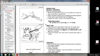

Post by WideOpenThrottle » Fri Sep 21, 2012 8:11 am
SLYDIT wrote:ignitor module?
by the way DO NOT pull the leads and crank the engine to check for spark...you will F*** the coil packs
oh and also the wiring loom to the coils can get damaged on the rear of the inlet plenum where it is is cable tied to the plenum
Funny..the workshop pdf says the opposite???

Post by na6*dori » Fri Sep 21, 2012 8:23 pm
the workshop manual is only good for things you know but cant remember lol, diagnosing.....fail haha na im glad its sorted, just ticking over the 200km mark on the new engine
Post by SLYDIT » Sat Sep 22, 2012 3:31 pm
theres been more than a few stories of cars going into workshops with something like a cas fault and when fault finding, the mechs have fried the coils...i wouldnt chance it.
not having the path to earth for the coil voltage causes the voltage in the coilpack to skyrocket. the insulation in the coil internals cannot withstand this extreme voltage and they die. cars which seem to eat coilpacks need to have the engine earths looked at.
