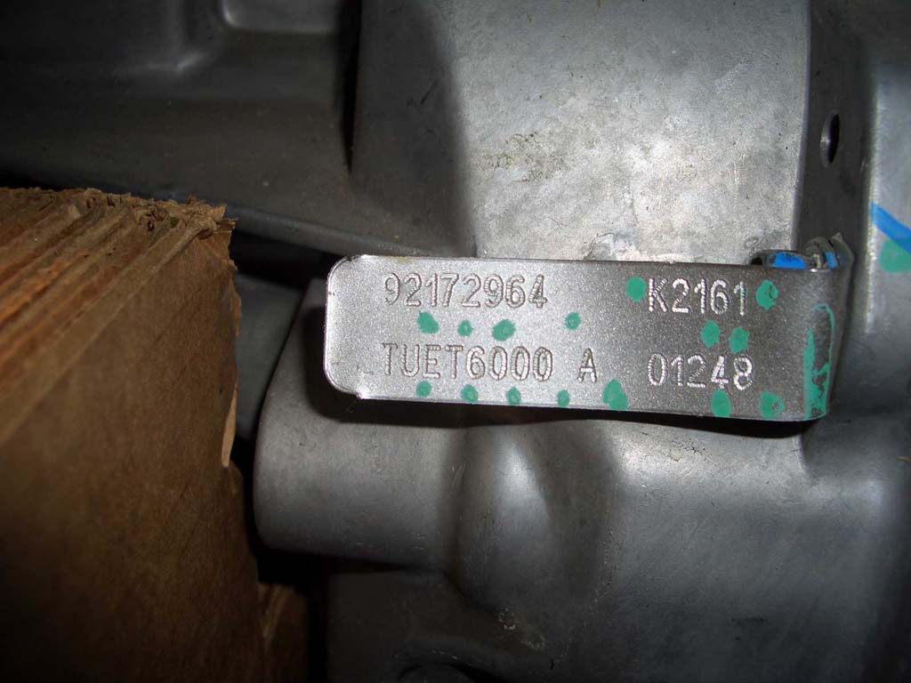

I think it's a good idea to buy an affordable gearbox that fits with the minimum modification, T56 are rated for fitment to mass produced cars based on GVM (weight of vehicle), as such they have to be rated for strength and longevity.
I'm sure the holden box is strong enough for a 1000-1200 kg car, a heaver vehicle loads up the transmission more due to traction and the need to use lower gears more...
The TUET6000 (Holden) is rated for 1550kg car.
I haven't listed the mods yet but have posted a few pics

Not sure,
mine is TUET6000
I emailed Tremec about it and they sent me this:
TUET6000 is for a 2006 GM Holden, T56, 475 Newton/meter for a 3,400 lb. GVW.
92172964 GM part number
K2161 build date Oct. 21 2006 First shift
