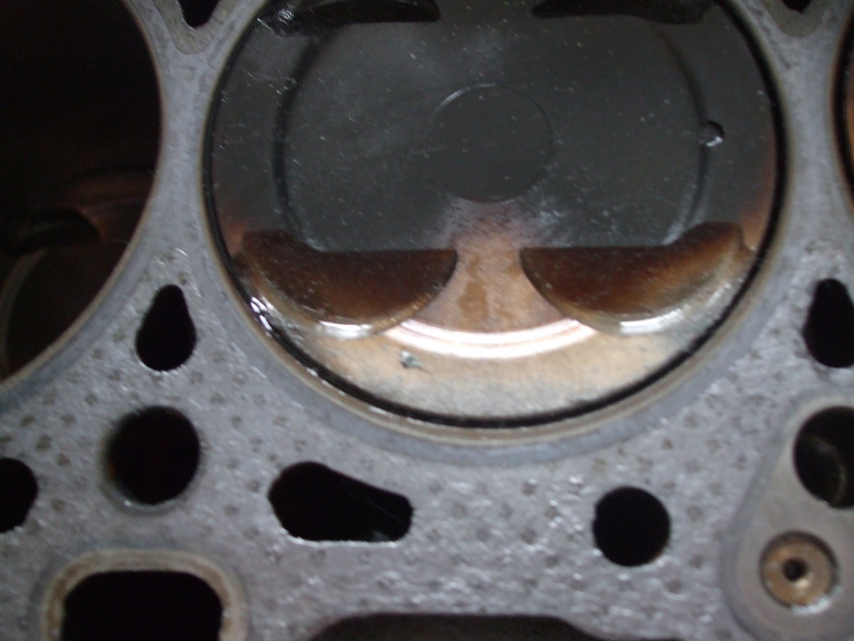

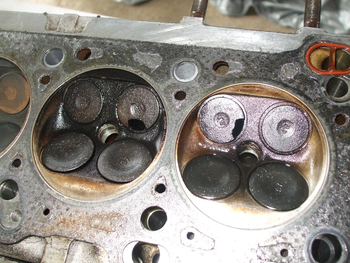

Post by WideOpenThrottle » Tue Nov 01, 2011 4:36 pm
My engine breathing has increased dramatically! :D
Two stuffed vavles & minor detonation on the piston tops...i think another engine is on the cards!

the pistons dont look that bad on the tops...ive seen fiat twin cams that look like the pistons have been shot peened....throw a ported head on it and itll be good for another hundy! :D
is that the exhaust valves that have shattered???do you know what your exhaust gas temps are? i know i cooked some valve seals when a slight tuning glitch meant i was running really lean at low throttle...EGT's must have been sky high...

Yep...both exhaust valves----got the pistons out today & one has minor top wall scoring, while another is quite bad.
Incidentally there is only some minor cylinder scoring & no lip around the tops so not bad really for a 280k engine.Will measure the cylinders for square & wear soon & decide which route to go from there!
Must have been hot in there but why only two crapped out? were the injectors running lean? Have just read that it could be the case from Flyin Miata as 4 is the usual culprit something to do with the fuel rail being fed closest to #1 which gets the most?
Post by SLYDIT » Wed Nov 02, 2011 10:03 pm
four and three usually go as they are at the end of the fuel rail.(hence why i did the dual feed modification)
but also #4 runs much hotter than the other cylinders as the water flow through the block is pretty uneven. Originally the B6 block as used in the 323 has the water going in at the front and out at the back... but in the mx5 they made the "out" at the front too for packaging reasons.
the only real water flow that #4 gets is assisted by the heater core pulling some water from the back of the head...
this is why some high HP guys do the coolant re-route mod which returns the thermostat to the back of the engine then runs a new pipe all the way to the radiator so the block gets a true diagonal water flow path.
oh thats also why its a REALLY bad idea to plug your heater hoses if your heater core leaks because your engine is on borrowed time...
