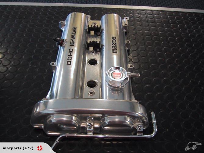

Post by brownie » Fri Jun 24, 2011 9:44 pm
The last one that came back was just luck,The owner stacked the car and work bought on Tender.
Here's a photo of how they come up.
Look even better when you do the inlet manifold as well with injector rail.

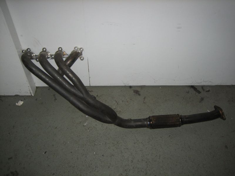

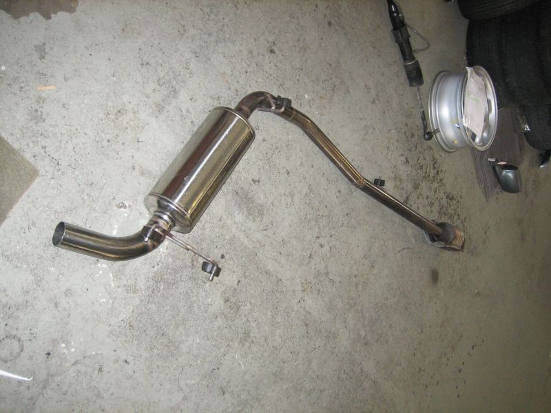

Post by mazline » Fri Jul 01, 2011 4:01 pm
Euen,
4-2-1 and join in a 2"inch collector and i have the matching exhaust !!
Just got to get off my ass and fit it all.

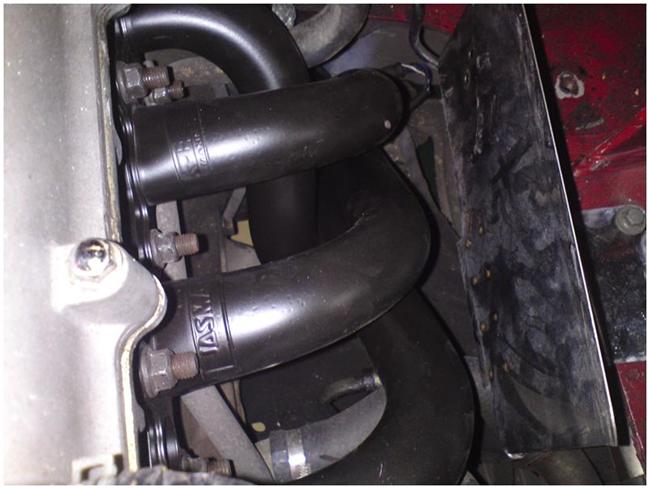

Post by Angreal » Mon Jul 04, 2011 10:46 am
Photos of my extractors post installation. Nice to know I managed to get a hold of some maxim extractors by chance and they seem to be sought after on the miata forums :D[/img]
Extractors
Copy of DSC01450.JPG (42.53 KiB) Viewed 14190 times

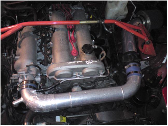

Post by Angreal » Mon Jul 04, 2011 10:50 am
I'd love to get my intake pipes and covers done with HPC but that'd cost a fortune which would be better spent elsewhere...
Engine bay
