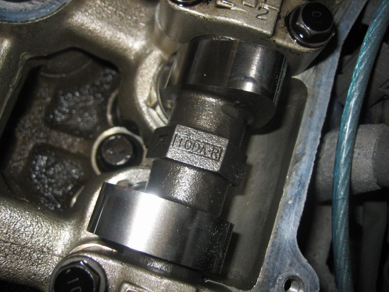

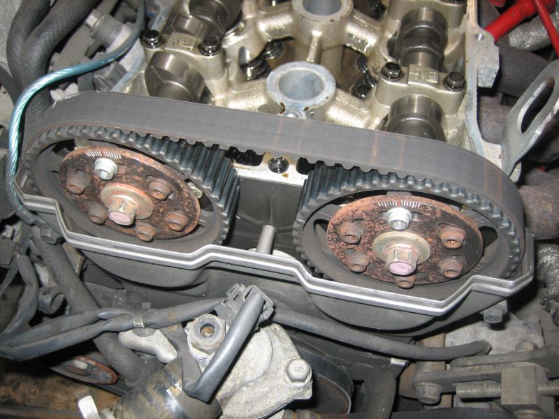

Post by mazline » Sat Jul 24, 2010 12:34 pm
Hairy Cams it is !!,TODA-R with adjustable camgear and a Basta*d to turn over by hand

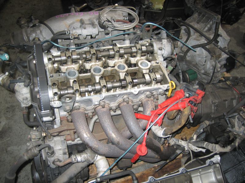

Here's another photo of the motor
