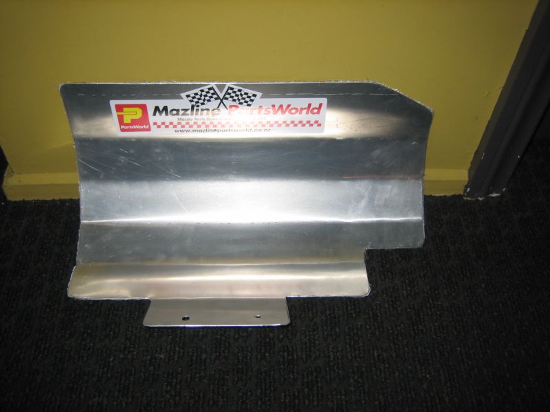

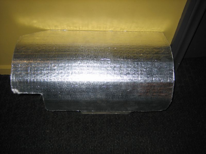

Post by mazline » Mon May 17, 2010 1:10 pm
If you use a pod filter we do sell a heat shield that blocks the hot air from the exhaust.It does have a heat resistant backing on it to stop heat soak.

Post by mazline » Mon May 17, 2010 3:38 pm
Here's a couple of photos of our heatsheld.
