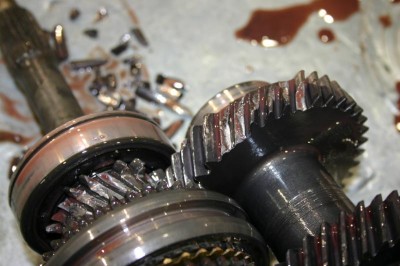

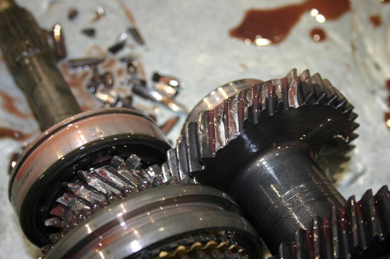

Whats the difference in the NB gearboxes that makes them stronger? What was it that kept blowing in the NA box?
Also, whats the car in the picture of the gearbox with the neat white letter tyres?
Mark at Mazline did a fantastic job packing this one up! Also he is sending me a brand new shifter boot, as this one was a bit worse for wear. Top service!
The difference in the boxes are the case thickness and the bigger sized input shaft bearing you can machine them up to carry.
What fails? input shaft bearing craps out due to additional unpredicted torque loading.... then that provides excessive endfloat of the input shaft....then the gear teeth get a little to much backlash....etc etc
The car is a Mopar '67 Valiant. Looks nice?
