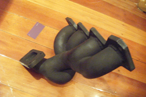

got my T25 today seems to be all good i shouldnt even have to rebuild it.
thanks alot 2low2c for the manifold i have welded up anywhere i thought it may have a crack
i would rather have this manifold than any of those "high performance" ones from trade me

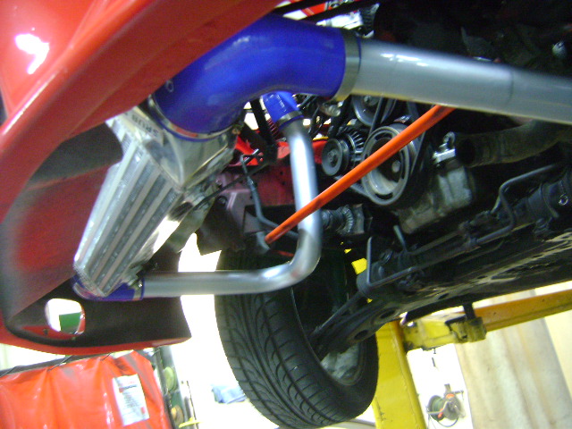

Post by sprsta » Sat Mar 28, 2009 8:25 pm
intercooler is mounted and most of the plumbing is done should be boosted by easter

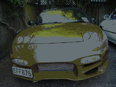

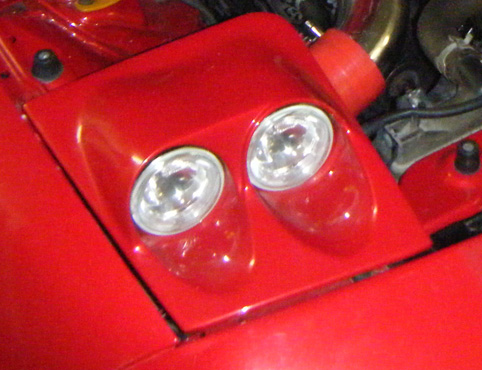

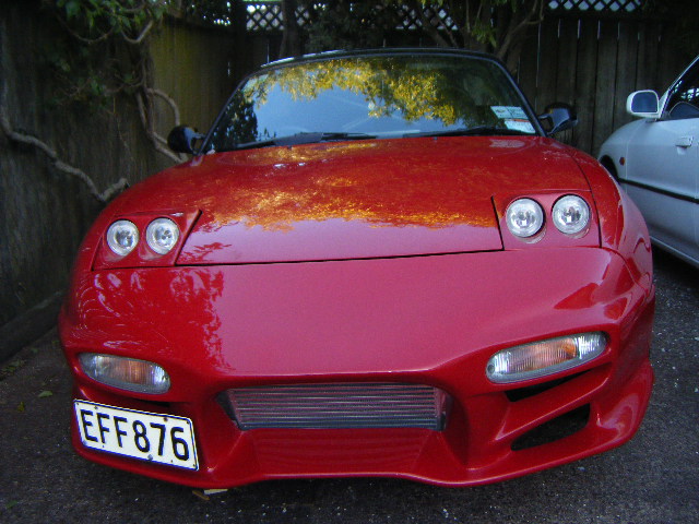

Cant quite tell from your photo but are your headlights slightly raised or recessed as i am after the latter? Ta.
Post by sprsta » Tue Mar 31, 2009 5:18 pm
hi they are neither they are aftermarket ones for a 180sx wich i have modified to fit my mx5 have a look in the garage section for some better pictures
Post by poison » Tue Mar 31, 2009 11:43 pm
Awesome job on the lights, a close-up photo would be good.
Post by sprsta » Wed Apr 01, 2009 8:13 pm
just click on the picture to see it properly

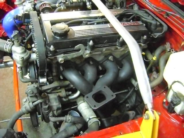

Post by sprsta » Wed Apr 08, 2009 9:39 pm
ok well heres my new exhaust manifold thought id mount the turbo foward and add some length to the front two pipes to keep them all reasonably even
last_resort14
Posts: 252
Post by last_resort14 » Thu Apr 09, 2009 6:02 pm
That manifold looks nice, and having it forward like that is a really good idea, if I were to make a manifold I would be doing something along those lines, you have heaps of room up there and it will make your downpipe so much easier.
Post by sprsta » Thu Apr 09, 2009 7:39 pm
that was the idea there is heaps of room behind the turbo but still have to make a 90 degree down

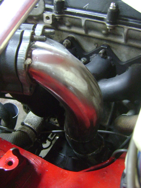

Post by sprsta » Fri Apr 10, 2009 2:16 pm
progress pics

Post by last_resort14 » Sat Apr 11, 2009 3:44 pm
Its looking good.
i wish i could build my car up as fast as you are.

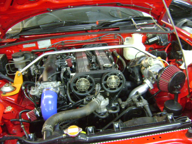

Post by sprsta » Sun Apr 12, 2009 12:12 pm
ok she is oficially boosted!!!!!!!

Post by sprsta » Mon Apr 13, 2009 5:31 pm
did abit of link tuning today shes getting better and better found my oil return line had abit of a leak where i had to bend it abit so have had to do abit of brasing today seems ok now tho
