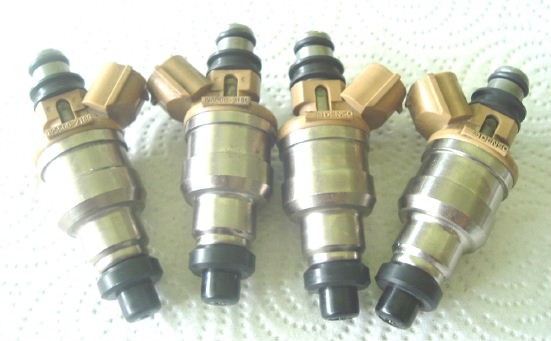

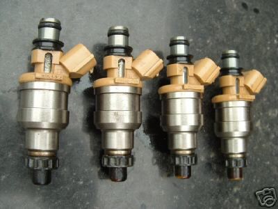

I'm having a set of larger (360cc) injectors cleaned and the guy wanted to know which seals the MX5 takes (lower - injection tip end), he said there are two types on Mazda's, one is smooth and the other ribbed( no rude comments please :) ).
I have attached photo's of both, from eBay as advertised being for the same model Miata, who knows, maybe it doesn't matter.
Anyone recognise which one is correct?

Gary, I don't think it makes a lot of difference as long as they are the same size and they seal. Both sets of injectors I have (96 and 99) are fitted with the smooth seals.

Thanks for the reply, I think you are right, even more so given the two types on the eBay photo's for the same model. The problem is I don't know the size until I do the swap, anyone have some on a bench? The one's on them now are from a GTX and may be different, who knows.

Both types are the same size,check the impedence and the lengh as someare acouple of mm shorter
Ihave spare seals of both types if you need them.
