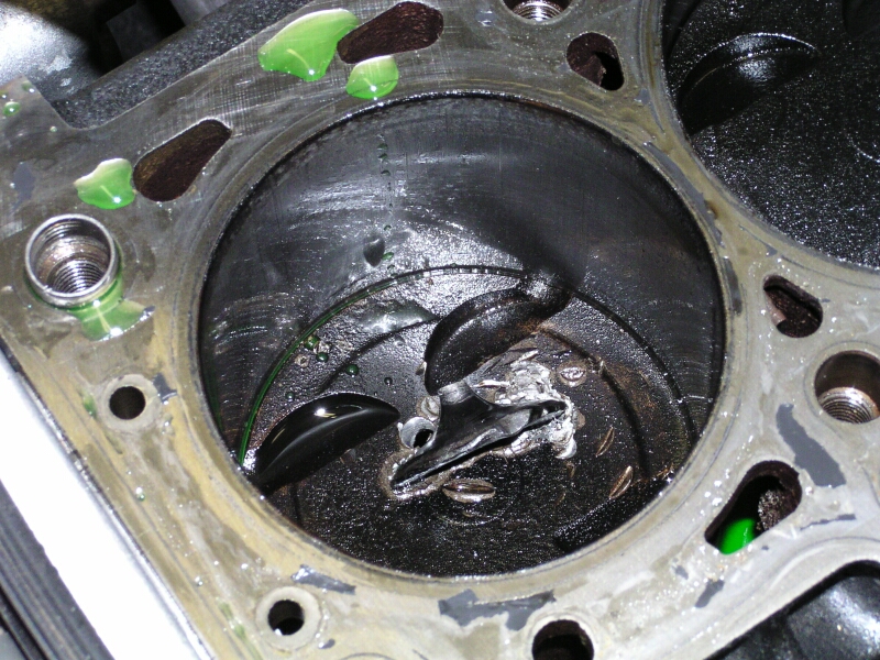

Heading down the southern motorway out of Auckland on Friday enroute to Rotorua when the dreaded death rattle hit me around the ears. Towed the car to a friends place in Mt Wellington to see if there was any chance of fixing it but when we couldn't get number 1 spark plug out we decided it was terminal. Towed the car home, parked it in the garage and headed off to Rotorua in the Subaru. Joined the Narva Tour for some of Saturday then dropped out to help a friend who had bent his BMW 320. Rejoined the Narva on Sunday and had a bit of fun on the stages. A bit of compensation I guess.

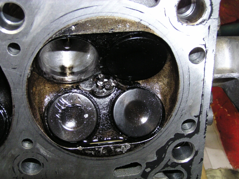

Got home today and pulled off the head and this is the mess that I found. The head of one of my nice new +1mm inlet valves embedded in No. 1 piston. The reason we couldn't get the plug out was that the valve head had smashed the electrode and the tip. The earth electrode was bent around and caught under one of the exhaust valves.

I wish I knew. Just cruising down the motorway at about 100Kph and it let go. The break on the valve stem is very clean and almost flat. Will discuss it with the suppliers and the guy who built the head but not sure if we will really find out why.

Update on the cause of the disaster, I sent some more detailed photos back to FM who passed them on to Supertech who made the valves. It seems that I may have knocked the valve slightly when fitting the head, causing a slight bend in the stem. With the running of the engine, this fatigued the valve stem causing it to break.
With the very narrow engine bay and wide front guards on the TG, fitting the head is not easy. It is necessary to have the inlet manifold fitted when the head goes on as it is such a PITA to get at the manifold nuts. This makes the whole unit quite heavy.
The safest way that I have discovered now is a 3 man job (having 2 sons still living at home does have a few benefits). Firstly, the cam bearings are released so that all the valves are closed. Then the head is slung from a long pole that can be held from either side of the car. The 3rd person carefully guides the head onto the locating spiggots from the front.
