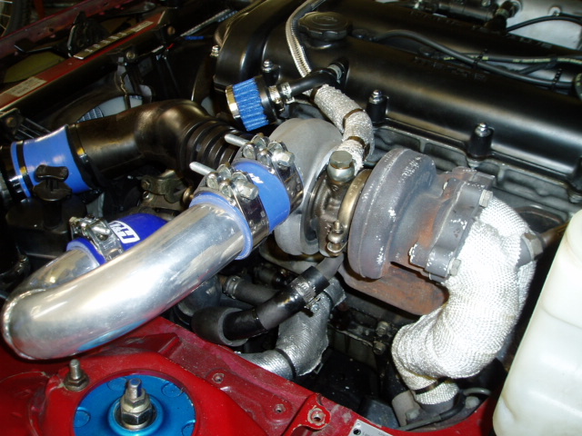

No more band aid add-ons, no more skinny squirters.....
This is the life!
last_resort14
Posts: 252

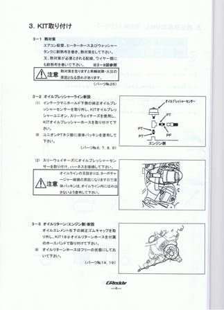

Post by last_resort14 » Mon Jul 20, 2009 6:48 pm
just noticed from your pic that you have your turbo oil feed coming from the intake side of the motor, was there a reason you didnt use the oil feed port on the exhaust side?
Habanero666
Location: NZ
Just following instructions!
Post by Habanero666 » Mon Jul 20, 2009 7:20 pm
I have followed the instructions with this kit because....... If you study the oil flow path of the B6 engine, it makes very good sense to have a oil pressure sensor on the same line as the turbo feed. I value the life of my turbo as much as the performance :wink:
