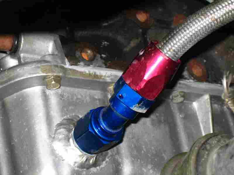

Last night I was mucking around trying to swapout rollcages (anyone want an old rollcage???) - anyway while I was in the garage I took some quick pics of the pan tap for this thread in case it is of use to anybody.
The most important thing to remember is to ensure that the oil runs down at all times and that there are no kinks, or low spots prior to where it enters the pan - you may not be able to see this from the pics due to the camera angle) If you dont get this right you will have problems.
The only item I would change in the above post is the 90deg bend - I went with an upward 130 and I personally prefer this to the sharp bend.
*** Edit *** pic to come - forum is not allowing me to post upwards of 4k just at the moment.

Post by Miatamad » Mon May 21, 2007 5:06 pm
Now that we can post pics greater than 4k :D
Here is the pic I mentioned previously regarding tapping the sump.
The angle is a little out but you should be able to work it out.
