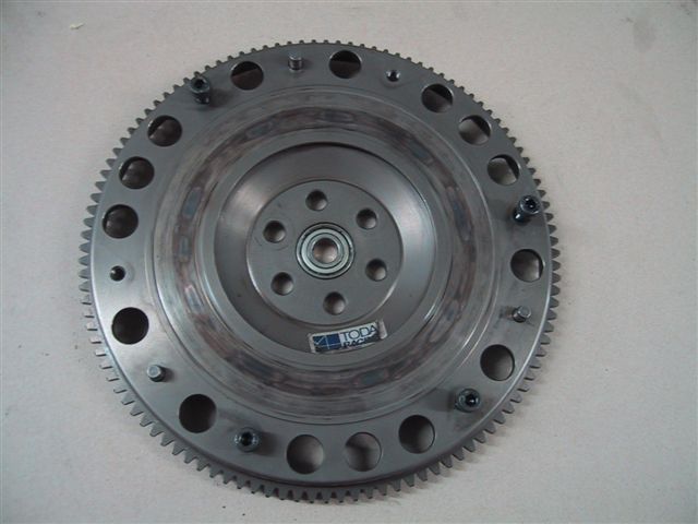

TODA chrome molly ,From factory 9kg down to 3.5kg !!,Super responsive,Just get used to revs dropping quickly,No good if you are considering Turbo,You need the weight to keep the revs from dropping too quickly.
Best performance mod in my books without touching too much
