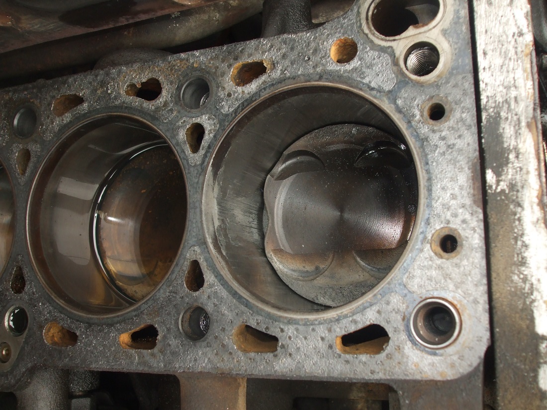

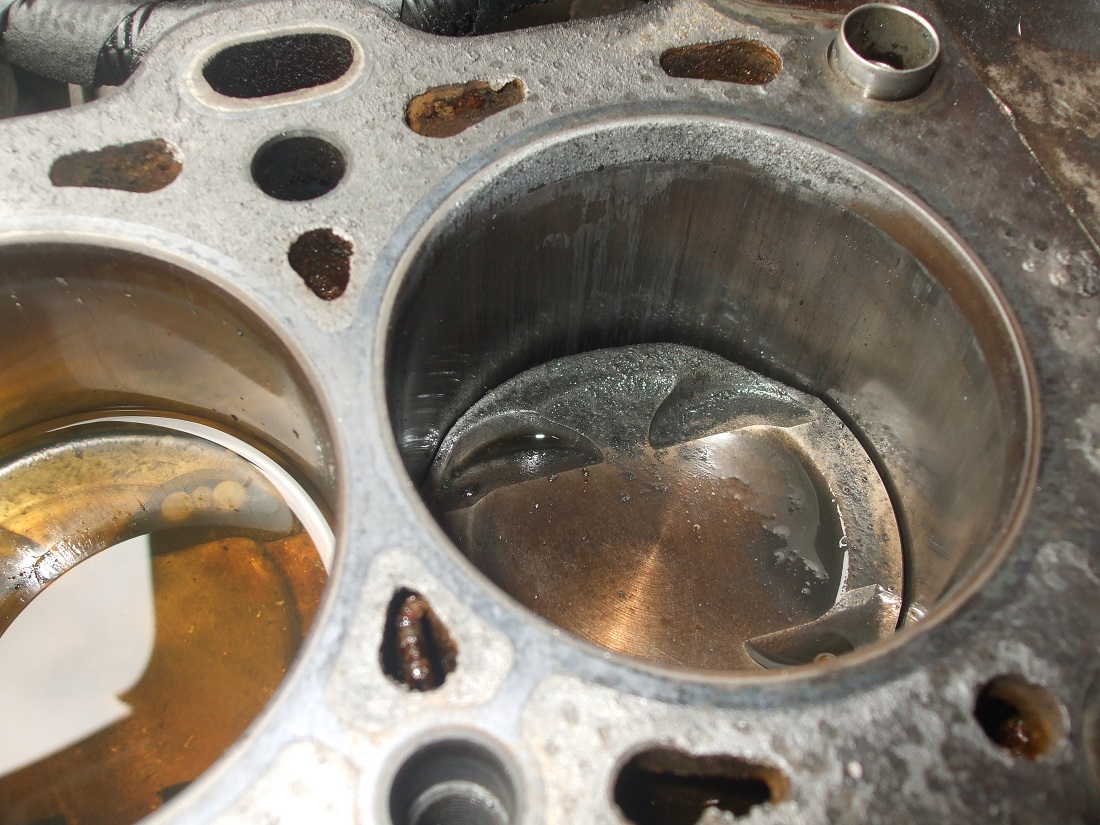

Pulled the head off a mates 1600 mx5 that had been running untuned from a previous owner.It suffered full loss of compression in #1 with partial loss of comp' in #3.
The oil in the other bores was put there to test how good the rings seal each piston as a guide to damage.
The pics says it all as there is evidence of detonation as well as the unusual smooth hole at the rear of the #1 piston where you can see the piston ring.
We are now looking at options of a rebuild or another good 2nd hand motor so if any one has one please let me know.Cheers.

For the flipside of the argument. If you know how to rebuild it, the head is in good Nick and the bores are fine I would rebuild it. It really only needs new pistons, rings, hg and any other maintenance items. If you're doing s full rebuild you've got a nice fresh motor. If you are buying another 2nd hand you've got no guarantees as to the quality of it other than visual external inspection
If its detonated that bad. I would bet that the rod and main bearings will be stuffed too.
Another engine with a new head gasket and cam belt kit before you drop it in.
Is it turbo or supercharged? If its just NA then drop in a 1800 NB ENGINE and retune
- Posts: 1293
Another motor is by far the cheapest and easiest but I know from experience its hard to find one that you could honestly say is a good one.
#1 bore is a definite re-bore as it is quite bad and may be too deep in damage to re-bore as I believe the walls are quite thin in these engines.
Good point about the bearings too!
