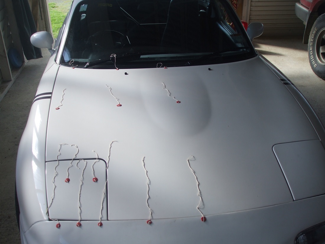

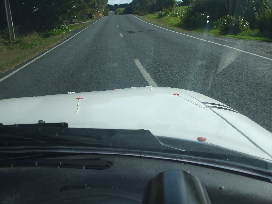

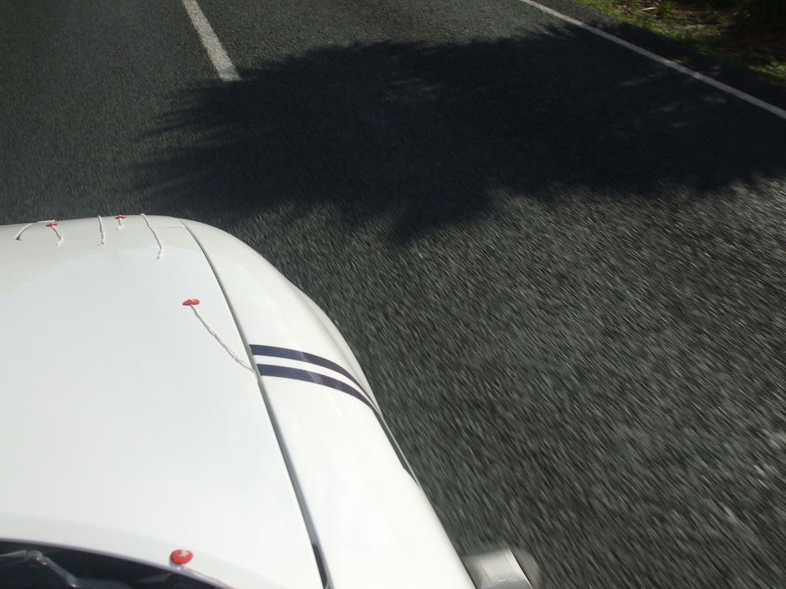

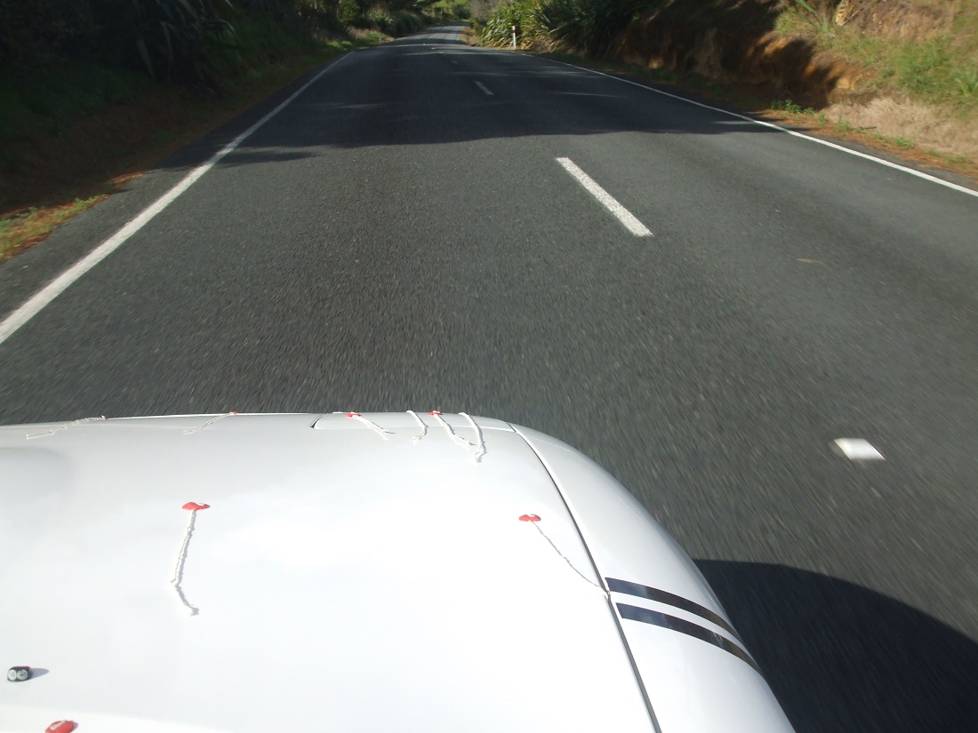

This is the result of 110km/hr wind flow over the bonnet.
As you can see from the pics,there is always downward and backward pressure on the strings.
The strings across to the centre of the bonnt from the 2 black stripes on the guard faced backward but i could see theyhad very little wind speed passing by them.
The far outer lower string either went to the wheel or got sucked into the gap around the light cover.
The 3rd lower string sometimes got sucked into the headlight gap.
At no point did any of the strings lift vertically.
This indicates that there is always positive pressure over all this area but it will be less than directly in front of the car.

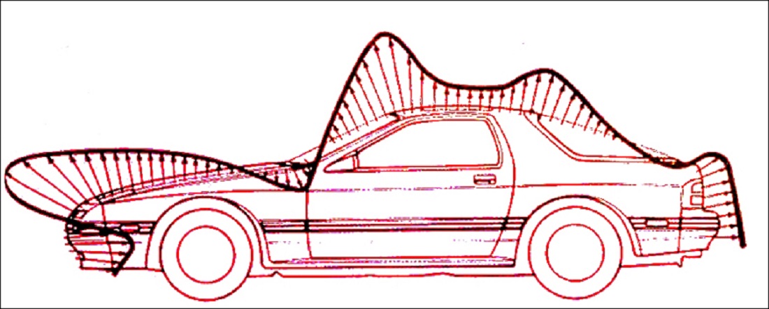

Pressure acts along the surface normal (i.e. perpendicular to the surface) so that's why the pressure vectors are shown that way- they don't represent air flow
Remember that even at rest, pressure is still being applied to a surface (albeit equally) due to atmospheric pressure (standard pressure = ~1013 hPa at 15 degrees C and close to sea level).
As soon as the car starts moving, pressure will begin to be act non-uniformly with areas of relatively higher pressure occurring where air is forced to change direction (i.e. at the front of the car). The area of low pressure at the base of the windscreen is due to the boundary layer lifting further off the bonnet due to the roof, leaving space where air is 'sucked up'

Hi Timmo...am bit confused on your analogy so in my case i will disregard pressure and only concentrate on wind flow such as indicated by my string test going on and in the headlight cover....which is what i was hoping for.
