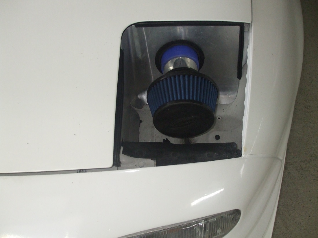

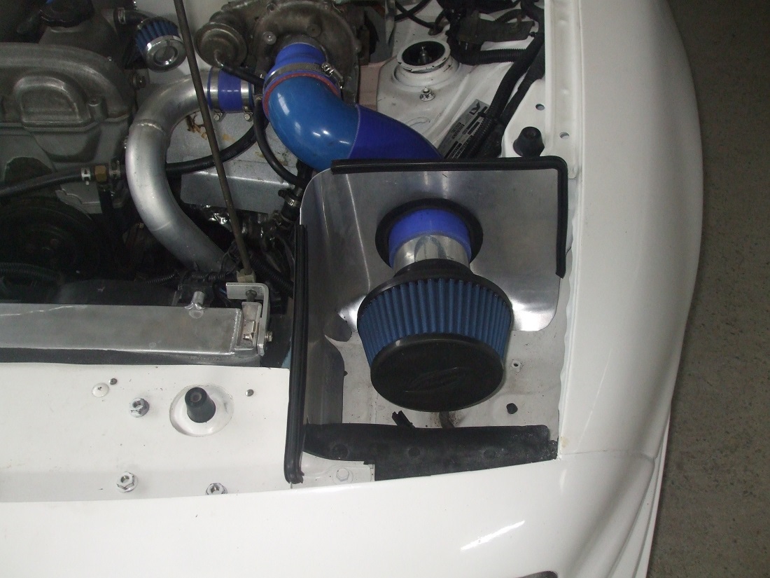

Will have this ready as a unit to drop in [with a different pod filter] at the track after i remove the light assembly there just incase its illegal for the road.
Just need to locate some bolt holes and source some rubber edging as it has sharp edges.

hmmm I would think that the extra drag from not having the headlight cover there would more than negate any advantages of a cold air intake.
It would be better to get an old headlight cover and fashion a vent into it for use with your trackday intake so you get the best of both worlds.

i have 3 things to point out here
1 on a turbo car if your intercooler is sized corectly this will make no differcene at all as the air leaving the turbo is alot hotter than the intake i run my filter directly on the turbo with no effect on performance from when i had it boxed.
2 if you wre to run it like that and it did force air in you could find it may run lean .

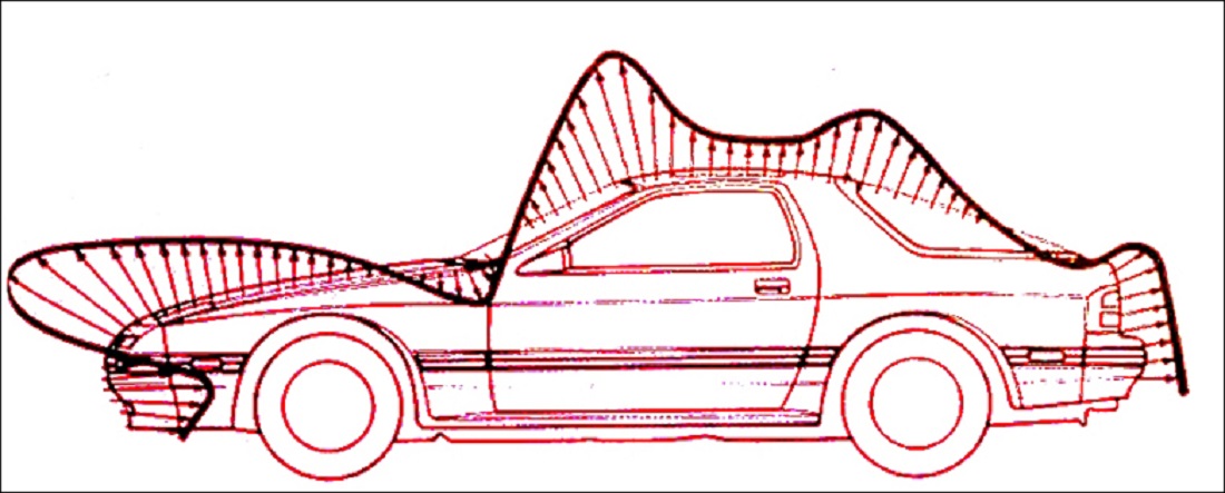

3 if your drawing is corect it would be in low presure zone in which case you could starve the turbo of air.
just my thoughts
just my thoughts
Yeah but you are comparing a smooth surface, where flow can remain fairly laminar, to an abrupt hole where air is smacking a surface perpendicular to its flow getting into all sorts of trouble since there are no easy escape paths for it.
Remember that the influence of drag is squared with speed so a couple of HP increase via the intake is going to be negated at fairly low speeds.
I just think, with a bit more work you can get the best of both worlds
(that's a picture of a FC RX7 too innit?)

I am not after more HP by doing this just after a cooler place to obtain air as my filter is normally mounted behind the top of the radiator and this position is where under hood temps are the highest and probably with slow moving air.
Why do so many people heat shield their filters if obtaining cold air is not relevant?..i for one cant & dont want to put my filter in a heat shield that is still inside a hot engine compartment.

1..Was your filter when boxed sucking hot air or was it fed cool external air?2low2c wrote:i have 3 things to point out here
just my thoughts
2..Its already forced by way of the turbo so i imagine i would have to drive at light-speed to cause this air to drive the turbo faster than what it already spins via the exhaust gasses.
3..The speed of the car causes an increase in air pressure at the front...the remaining sheltered/lower pressure air is still normal surrounding air pressure.
Sheltered spots are not starved of oxygen otherwise every race car that drives in the sheltered lower pressure slipstream of the car in front would suffer engine damage...and they dont!
