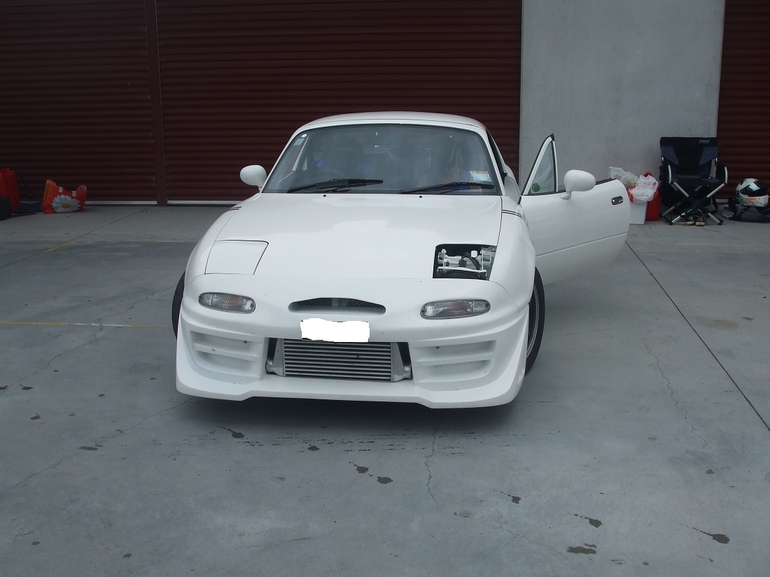

Post by WideOpenThrottle » Sat Jan 12, 2013 5:02 pm
Firstly car performed wonderfully....not scary but very drivable & only got a little bit warm around the midday heat.First time in my new turbo set-up,race seat & harness.[Damm it was a hot day...need to go in winter only me-thinks].
Ended up in battle with a black Honda S2000 most of the time..initially i was faster everywhere but as the other fellow grew in confidence we ended up about neck & neck....i was faster in the corners :D but his acceleration on the straights was a little bit better than mine :(
Felt good to get past a mustang several times plus a few beamers.
I was running with my headlight cover off for better cooling and found that this has cured my motorway stumble at cruise/vacuum as i drove home with it off as well.
Obviously i need to get more cool air into the filter & engine bay by the looks of it.
Only two other mx5's today and both were doing well for standard cars.

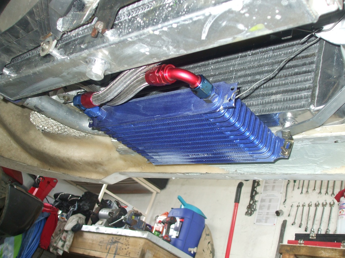

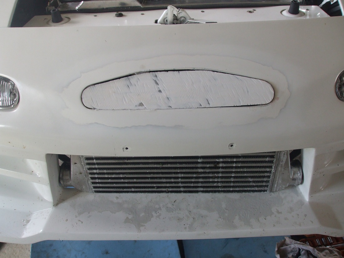

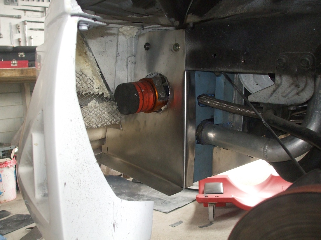

Post by WideOpenThrottle » Tue Jan 15, 2013 5:58 pm
So...to combat some heating at track days i have re-located the oil cooler so it no longer sits between the IC & the radiator & started to plug my top vent...apparantly it may be sucking out air that should be drawing through the radiator.
The new oil cooler position means now i will need a different front under-tray.

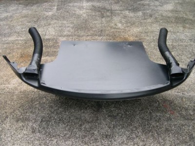

Post by Keith Jones » Wed Jan 16, 2013 3:30 pm
Nope, just a flat tray that extended back to the sump.See pic.
I didn't have the radiator/intercooler ducted either.
When I first built the car I went to great pains to make sure that everything was sealed off at the sides and all the air had to go through the intercooler and rad. When I rebuilt the front end after an accident at Puke I didn't reinstate the ducting. It didn't change the temperature of water, oil or air (in the inlet manifold) at all.
Post by Snapfrozen » Wed Jan 16, 2013 6:02 pm
Keith, I have to ask...
WHERE DID YOU GET THOSE DUCTS!! They seem to be a perfect fit and exactly what I've been looking for. Any chance you'd mind sharing your secret?
Post by Keith Jones » Wed Jan 16, 2013 8:13 pm
Marley downpipe fittings (rectangle to 60mm round adaptor) and very careful use of a heat gun!!!

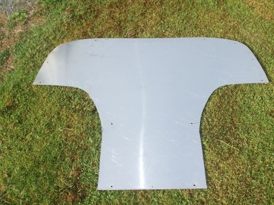

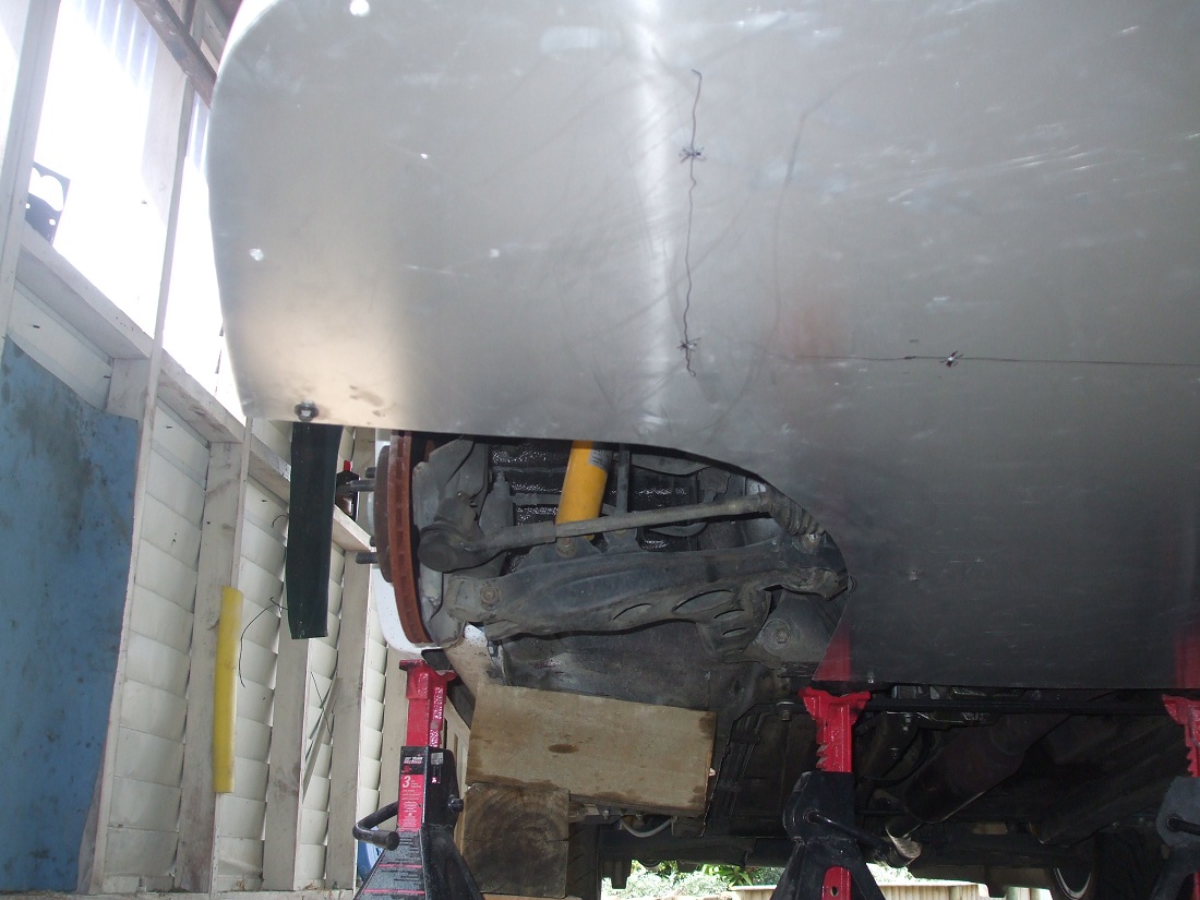

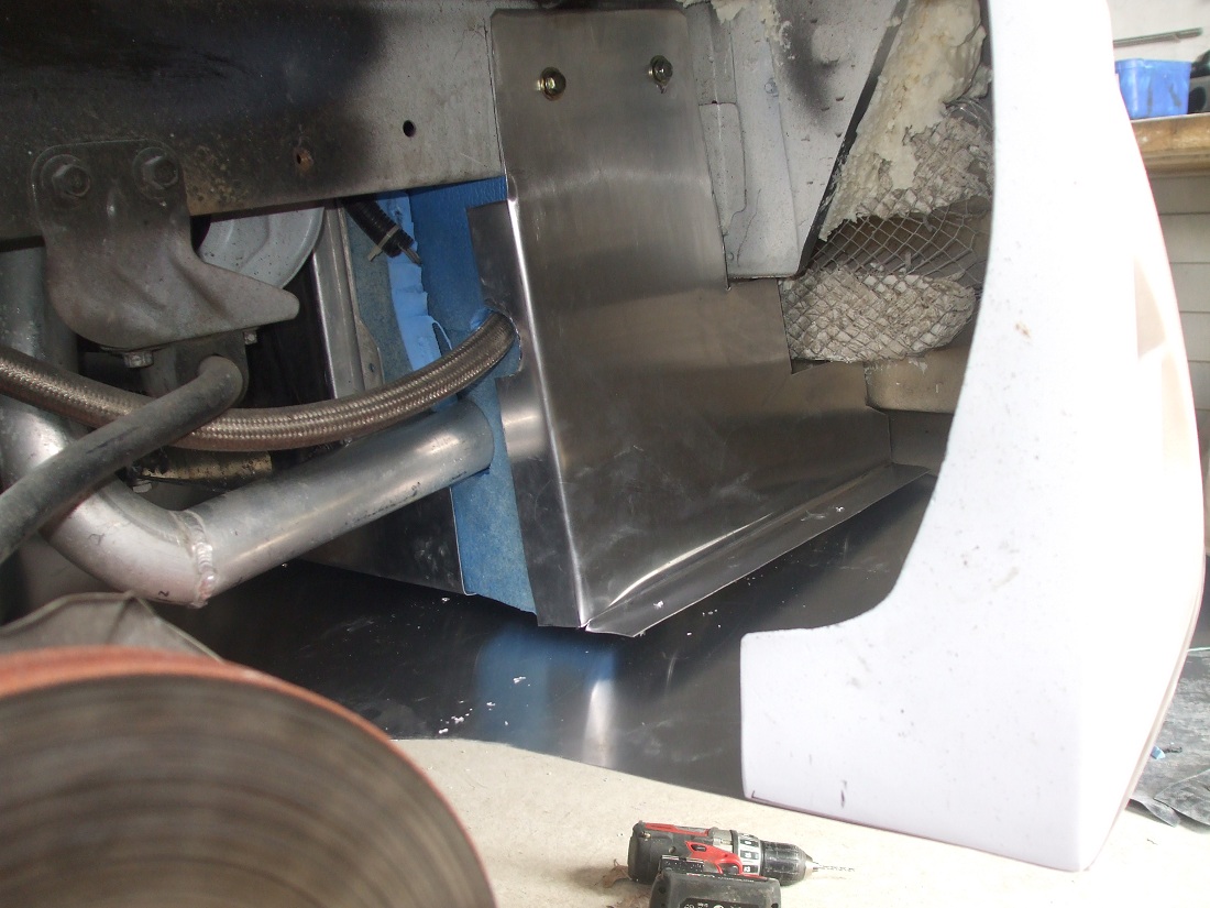

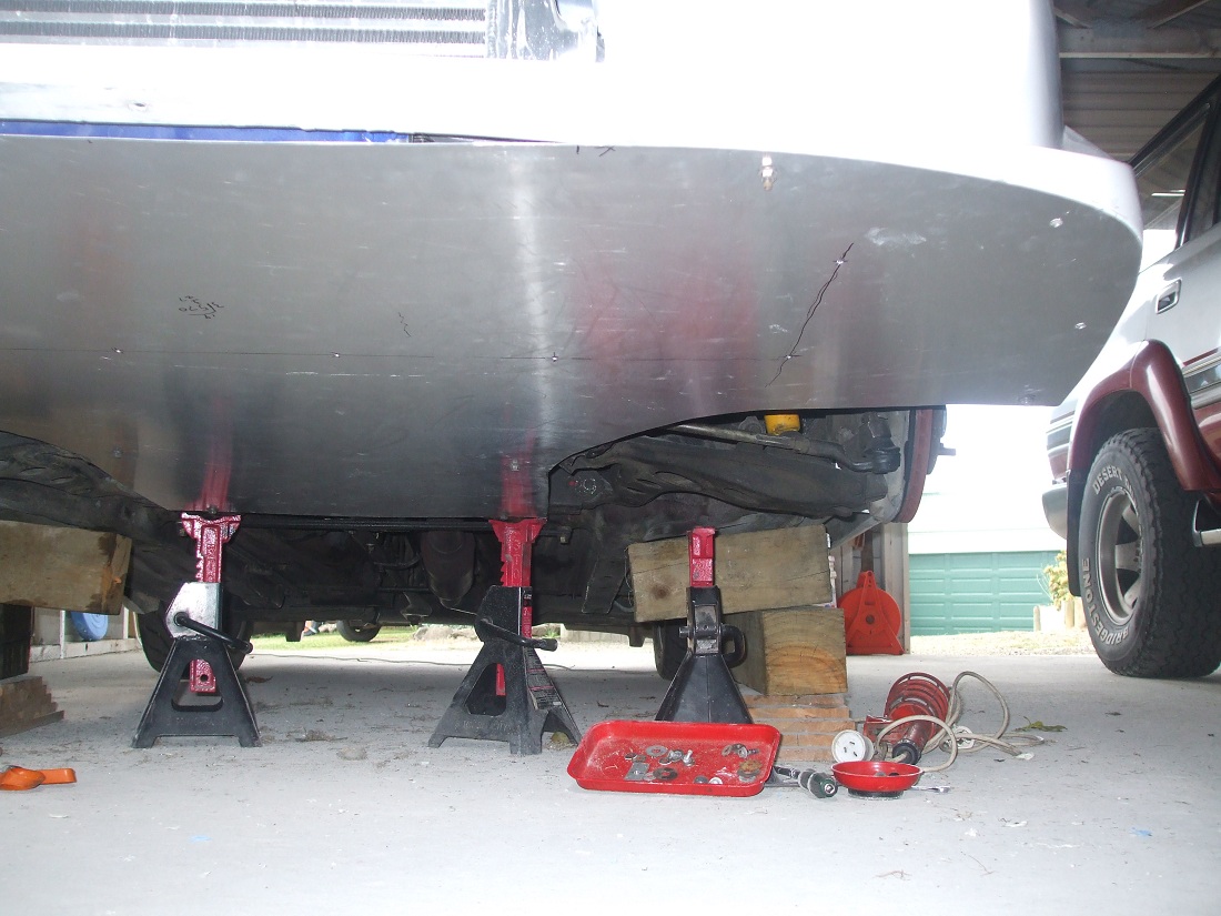

Post by WideOpenThrottle » Thu Jan 17, 2013 5:21 pm
Progress pics of the last couple of days :D
Combination of aluminium sheet,expanding foam & spa cover
Post by Snapfrozen » Thu Jan 17, 2013 5:39 pm
How thick is your alloy?
Post by WideOpenThrottle » Thu Jan 17, 2013 6:36 pm
The sheet was 2400 x 1200 x 0.7mm & cost $68.00 from Ulrich.
Easily cut with tin snips & hand sandable to smooth out burrs & get good shape.Nice & light too!
Its too thin to span the length/width but i have fixed it to an angle plate to stop airflow below the radiator
