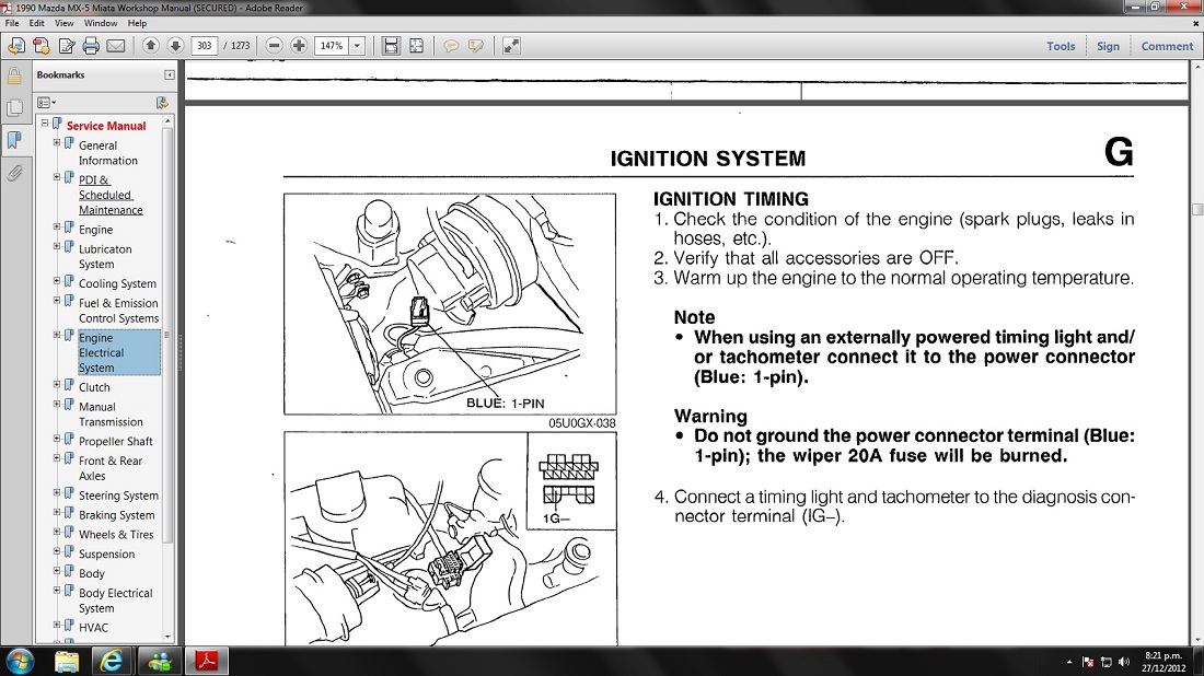

How do you get the timing light to work with the battery being in the boot?

Post by stooji » Thu Dec 27, 2012 6:30 pm
one jumper lead from positive to get power to the front is prob the easiest. can just clip the earth to the engine or similar.

Post by WideOpenThrottle » Thu Dec 27, 2012 8:25 pm
siren676 wrote:Sounds good then, will have to borrow my dads timing light and give it a go.
Use the blue connector as shown
