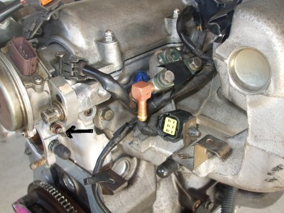

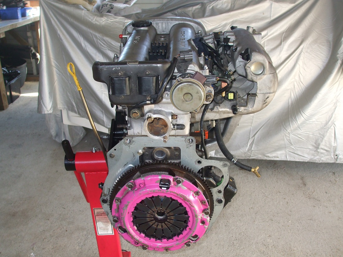

Post by WideOpenThrottle » Wed Nov 07, 2012 1:12 pm
Here is my dual feed rail..cost me $30.00 maybe [fittings & hose].
Rail end with soldered,threaded brass elbow [ignore the black arrow].
Brass tee for feed to front and rear of fuel rail
