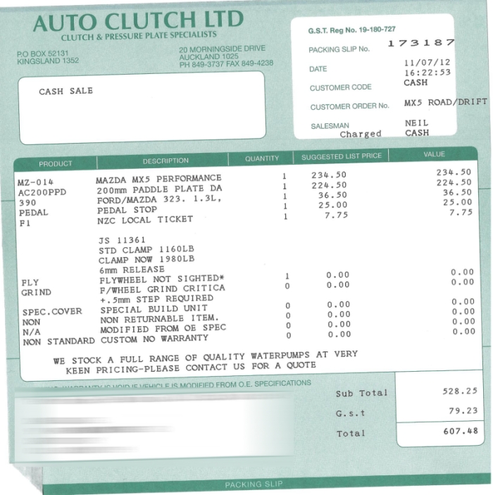

Sent an email off to autoclutch and they are going to make me a paddle clutch for cheaper than I can get the exedy kit for.
I asked him about the exedy ones and he told me that they haven't improved with their spring issue.
Cheers punkoutnz for the tip

What price range was that? I think I'll be needing a new clutch soon
Post by siren676 » Wed Jul 11, 2012 6:19 pm
$607 inc rural shipping.
The exedy one in the link i posted was $650ish
Post by siren676 » Sat Jul 14, 2012 6:15 pm
:twisted: This is going to be sweet
