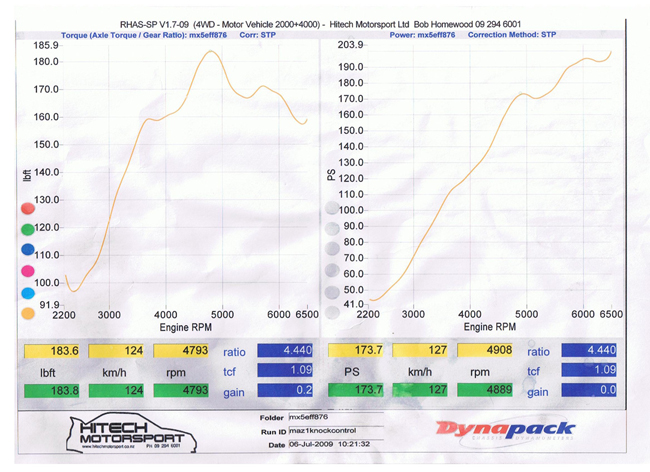

all tuned runs very smooth throughout the rev range
pretty happy with it

Great result that, odd torque spike though. Dont know much about turbos, but it looks like the boost really winds up at about 4500 and then cuts at 5000rpm. Guess if it runs right thats all that matters.
Post by sprsta » Mon Jul 06, 2009 9:23 pm
something wierd with the ecu it keeps pulling spark just after 5000 its like knock controll is doing it but even with knock controll off the ceu still pulls back the numbers we put in bob reacons he could get more out of it with a newer model ecu
she was blowing copious amounts of black smoke on the first couple of runs no smoke at all now
it used to lean out when entering boost then get crazy rich, the afr is alot better now
dynofiend
Post by dynofiend » Mon Jul 06, 2009 9:54 pm
Try a different spark plug? I understand turbos put different requirements on spark plugs and require different gaps, coldness etc?
If the ECU is pulling the spark, something is telling it to do it, and there arent many sensors that can do this other than knock or the rev limit are there? Makes me think its not the ECU stopping the spark but something in the ignition system itself.
Post by sprsta » Mon Jul 06, 2009 10:07 pm
we did afew runs with the old plugs then put some new bkr7 colder heatrange plugs in for the rest of the session
it doesnt matter what numbers we put into the ignition zones it just kept pulling them back to 0* after the run

Post by Habanero666 » Tue Jul 07, 2009 8:31 am
Retarded ignition timing = black smoke
Question: What is the CAUSE of ignition timing reduction?
Post by sprsta » Tue Jul 07, 2009 10:43 am
thats a good question
the smoke on the first few runs was way too much fuel an probably very retarded
by the end there wasnt any at all
dynofiend
Post by dynofiend » Tue Jul 07, 2009 7:39 pm
Habanero666 wrote:Question: What is the CAUSE of ignition timing reduction?
Is that rethorical? If not, then the only thing I can think of is the knock sensor or just the engine timed wrongly!
Habanero666
Location: NZ
Post by Habanero666 » Tue Jul 07, 2009 9:35 pm
Well it wouldn't be the knock sensor, as Cole has stated that timing is pulled with the knock correction function switched off.Could however be a wiring fault.
HAR HAR at a stab I would say the Soft rev limit!
Knock timing reduction will pull off degrees of timing, not reduce all timing to zero.
Also good point dynofiend, could be that timing at the CAS is incorrect or the cam driving it.
NEED MORE INFO COLE :wink:
Post by sprsta » Tue Jul 07, 2009 10:16 pm
we checked base timing before setting it up on the dyno the cams were set at the factory position
limiter was set at 7200 so soft limit should come in about 7000 not 5200
we put numbers like 11 in and the knock controll should only pull 6 so i dont know where the other 5 went
i think i might start saving for a G4 miatalink slowly
is there anyone on here who has tried one yet?
possibly a cpu fault?
i might try changing to the chip i got from you andput my numbers into that

Post by sprsta » Wed Mar 17, 2010 8:09 pm
old thread i know but i think i have fixed the timing issue
i had abit of spare time this arvo for some poking around in the engine
there was a broken bolt in the starter motor bracket so have taken that out and replaced it
the bracket is right next to the sensor so may have been vibrating at certain loads/revs
ive put some numbers into the ign zones that were affected and they are still there :lol:
went for a hard boost and only recorded one knock in about half an hours hard driving
still not sure why it was taking timing out without knock controll on
would like to do a power run on a dyno to see how she goes now that i have some real power above 5500
HUGE difference :P :P :P

Post by SLYDIT » Thu Mar 18, 2010 8:54 pm
that dyno curve is a classic mx5 turbo line. There seems to be some sweet spots in the efficincy of the engine (or a couple of holes depending on how you look at it) that require a fair bit of fiddling to cure.
On my car it required a heap of fuel adjustments to flatten out the curves. the timing was fairly consistent as we just kept advancing the timing until we weren't seeing any real gains in HP from just timing changes.
