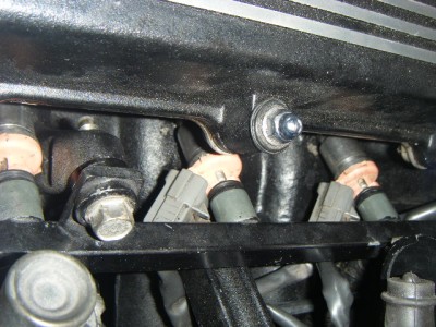

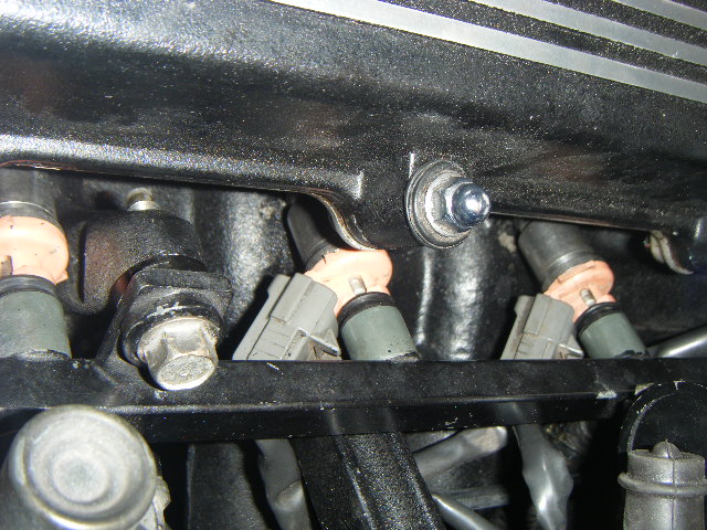

Post by sprsta » Tue Jun 30, 2009 5:31 pm
my pretty pink injectors are in now and knock sensor is finally fitted
cheers 2low2c for the advice on the spacers took about 1mm off

Post by Habanero666 » Tue Jun 30, 2009 6:04 pm
Now that there, is some serious delicious strawberry scented injectors right there :lol:

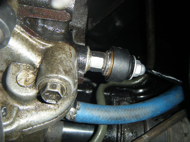

Post by Habanero666 » Tue Jun 30, 2009 6:10 pm
Sorry jokes aside Cole,
I really really recommend that you put the knock sensor on the inlet manifold side and atleast next to the cylinder bores, or some where there abouts on the block.
There are ample unused threads just above the engine mount there.
:wink:

Post by sprsta » Tue Jun 30, 2009 6:41 pm
yeah i have that manual i will change it over when i get a chance i only had a 7/16 spanner to do the 14mm bolt so didnt want to use that to tighten an engine mount bolt also the way i have it is in the block in one of the old a/c pump holes whats the difference between inlet and exhaust side? doesnt it just listen to the block as a whole
also just to clarify are the fm install instructions correct for the genuine link chip for the knock sensor with reguard to the wiring changes?
A:The whip side of piston travel is on the exhaust side, as the piston changes direction <- ^ ->)) and travels down the cylinder wall under pressure on the power phase.
It is very "noisey" on this side under normal operation.... BUT the whole purpose of the knock sensor is to detect preignition or detonation which happens on the upwards travel of the piston as it reaches ((<-TDC during the compression phase.It occurs on the Inlet side of this motor.
When the piston is at BDC it too changes direction <- But the inertial load and lateral shift of the piston at this point is less noisey and severe as the piston starts on the exhaust phase with very little resistance.
Hope that sorts it for you.
