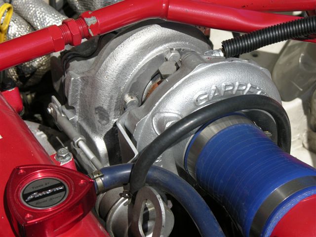

My DIY Turbo build

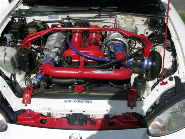

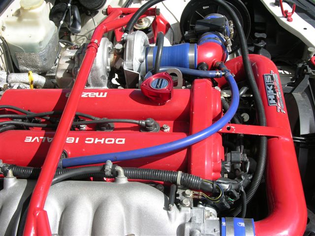

This is how I Tidied up My Rocker cover etc .
Used high temp engine enamel from spray can.
As you can see came up quite well and has proved to be durable,
Good luck with your project
Regards Ken.

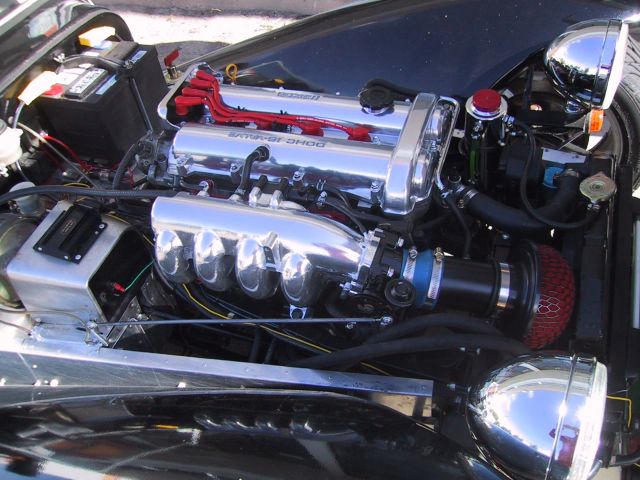

Post by brownie » Tue Jan 20, 2009 10:58 pm
Have thought about HPC cooating ?,Very good heat resistance and will not tarnish .I will post a picture from work to show you,

Post by brownie » Wed Jan 21, 2009 11:15 pm
Post by brownie » Sun Jan 25, 2009 8:53 pm
This what they come up like .No problems with heat from the motor or any thing,You can even clean it down with thinners and it will not do any damage.

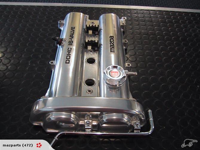

Heres where i have got to with my rocker cover, i just need to do a bit more sanding down the middle then i will take it into my mates work and give polishing a go.
I also intend on polishing my intake manifold and the water outlets and maybe other little bits and pieces but im still trying to decide if i should do it myself or just take it somewhere, my fingers are just sick of sanding, lol

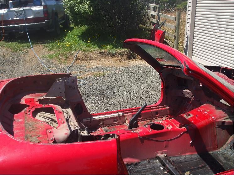

Hi everybody,here's some pics of my project
Post by brownie » Tue Jan 27, 2009 10:30 pm
Here's another photo from one of my customers that i had done for him in HPC Coating,This is now a Turbo Lotus 7 aiming for 300hp at the wheels in a 500kg car !!!! MADDDDDDDD
Post by WideOpenThrottle » Wed Jan 28, 2009 7:11 pm
Great pics, i'm having trouble doing mine

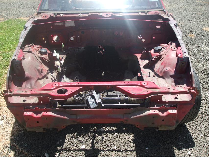

Post by WideOpenThrottle » Tue Feb 03, 2009 9:17 pm
Try'in again with my pics
Post by WideOpenThrottle » Tue Feb 03, 2009 9:39 pm
And another

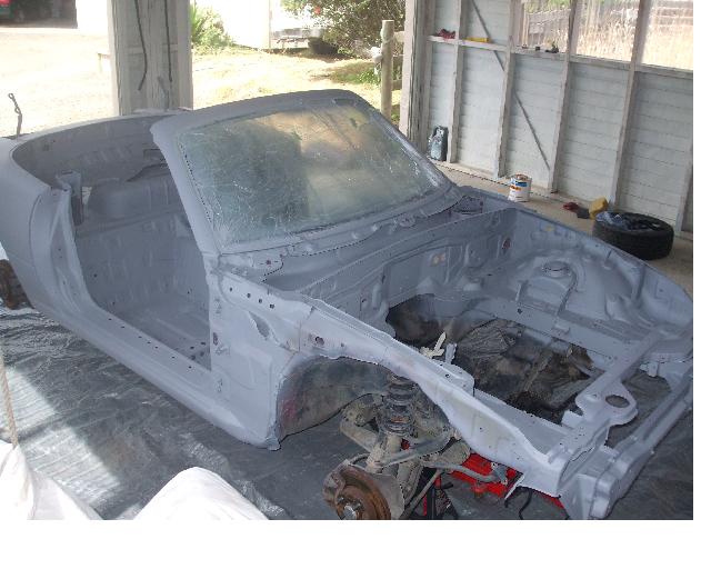

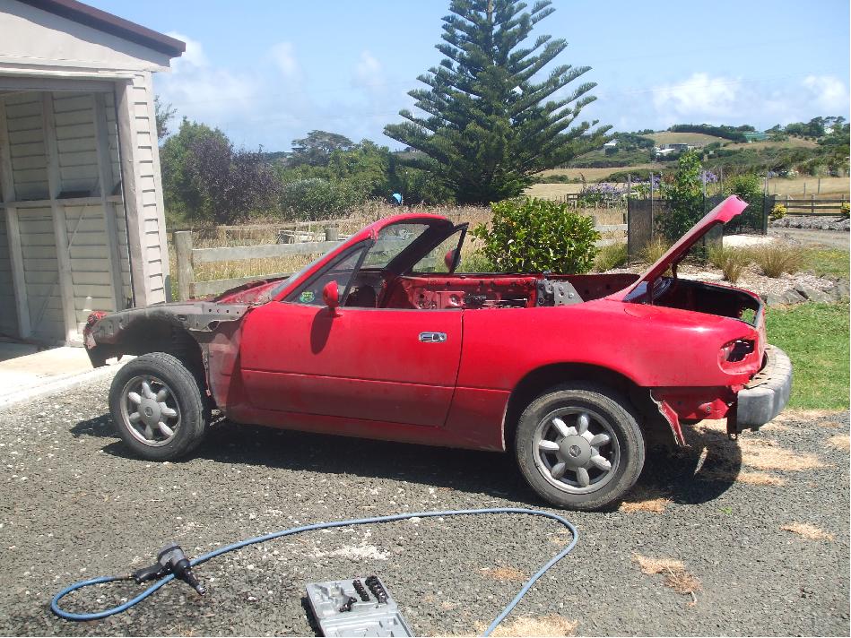

Post by WideOpenThrottle » Fri Feb 06, 2009 4:59 pm
Undercoated today
Post by SLYDIT » Sat Feb 07, 2009 2:10 pm
What sort of paint are you using??
Im thinking of painting my car as i have a "professional" spray gun and access to a workshop.Ill probabaly just do it red again.
any tips/tricks to spraying in your garage?
Post by WideOpenThrottle » Sun Feb 08, 2009 8:30 am
I use Koala Kare washable degreaser from Supercheap,then i dull the car with Scotchbrite pads & wipe over again with Dulon Autothane grease & wax remover. I then sprayed with Dulon Autothane primer/filler diluted with Dulon two way thinners approx 1 part paint to 1 part thinners.Spraypainting is a bit of a learned process of keeping the gun parrallel to the surface at the ideal distance away to give you a good wet looking coating without runs.Leave any runs or imperfections to dry for half an hour or more,sand & wipe again with Dulon wax remover,re-spray the area.Your Garage needs to be well-lit & as clean & dry as possible & spray only on low humidity dry weather days like what weve been getting lately.I also put a big tarp on the floor, to catch any spillage & reduce dust.I,m not a proffesional painter so there may be a better way! Good-luck & dont forget to use the proper mask!!!! Adios amigo

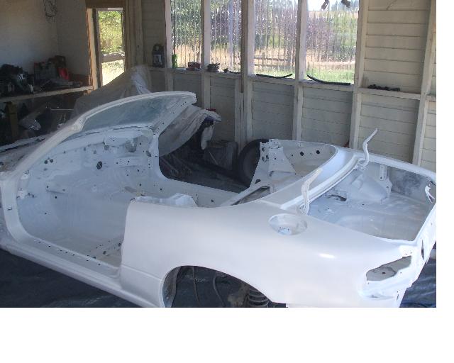

You never know, you may have a hidden talent. Just finished the first top coat.
Also check with someone about all the adjustments of your spray gun.
