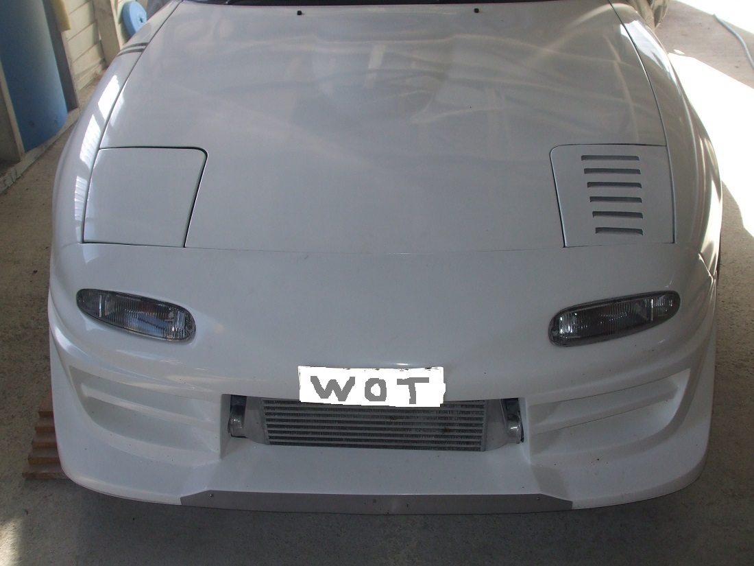

Go with a vented headlight cover, rather than just removing it completely.
As you know, but air intake is positioned in the worse possible place it can be for the moment, but even in that place, running a vented headlight cover over just a normal one, got me another 15kph down the front straight at Hampton's, which just meant that I destroyed my brakes ever faster (sigh).

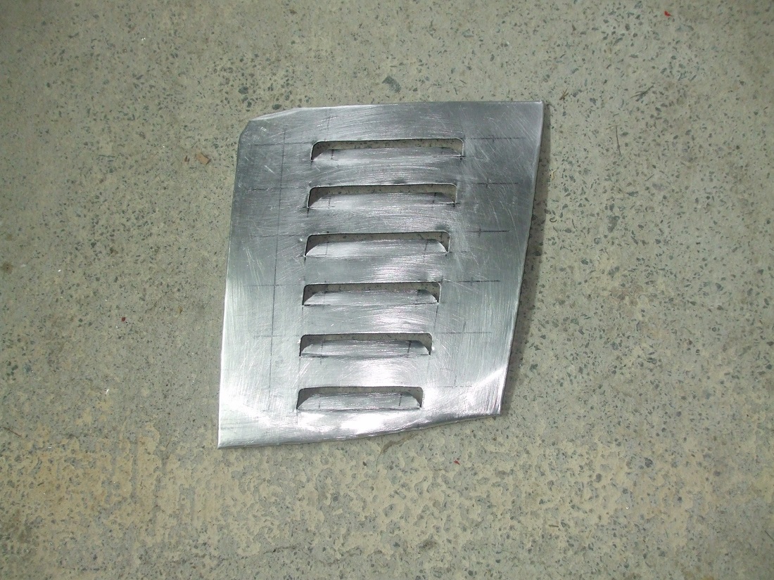

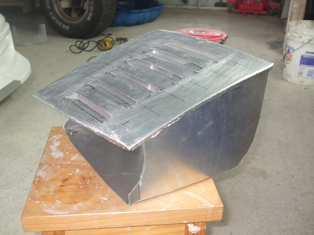

Its a track /road car and will try with & without the cover/shrouding to see if there is any noticeable difference.
If there is then i may put a scoop on the headlight cover & cut a hole where my vents are.

cold air scoops
If you're thinking scoops W.O.T. can I suggest checking out the 2 dollar shops cooking utenciles. There are a huge selection of ladles spoons fudge trays e.t.c all stamped out just crying out 2 be trimmed up and used 4 greater things. Food 4 thought anyway ? Let or artistic licence run amok.

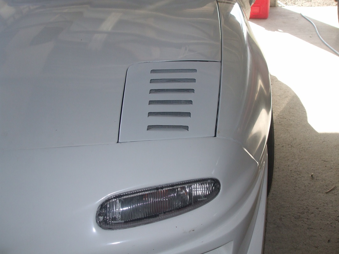

Had a fun day at Puke yesterday with absolutely no heating issues like what I had at Hampton Downs but this could be due to four factors..
1....cooler daytime temperature
2....relocated oil-cooler
3....Proper shrouding of intercooler and radiator
4....Cold-air intake via the head light which even with an exposed filter caused no lean conditions or noticeable turbulence.
Whether I gained any power or not,i had no way of measuring it BUT...for only 171whp I did seem to be more than a match to a lot of the field!
