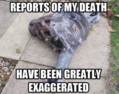

Didnt blow it up, a little dissapointed...
Snapped a caliper bolt so it had the same effect as wrecking bearing caps, already installed new diff Haha

thats a viscous

Lies!
Diff spotters guide: 4 ears with studs on the stub axles. They stopped using stub axles toward the end of the 1995 model year, so it's a 1994-1995 1.8 diff -- either open or Torsen
- Posts: 1115
Post
by siren676 » Wed Oct 02, 2013 10:16 am
I was just going off that it looked smaller and had the plates on the ends
