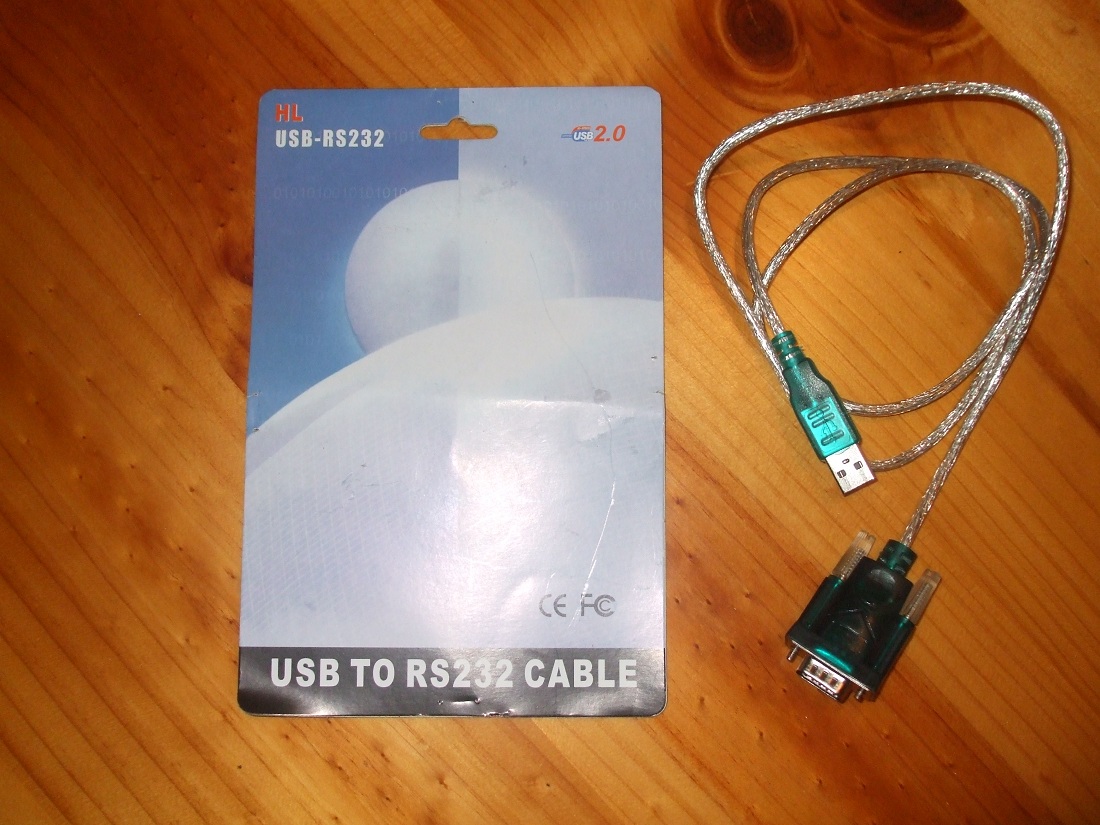

Post by WideOpenThrottle » Wed Sep 12, 2012 4:57 pm
Somethings amiss...cant get communication on two of our lap-tops or our home PC :?
Unable to download usb cable drive from the supplied cd or the internet on the two lap-tops.
Our home pc downloaded a driver for the usb but still wont communicate even tho it looks like it is ok!
I'll admit to being fairly un-geeklike but this is driving me to distraction!
Read somewhere i might have to get a better quality usb cable so will hunt one down.

Post by WideOpenThrottle » Thu Sep 13, 2012 6:46 pm
Here is the pic of the cable- needs to work on windows xp
Post by siren676 » Thu Sep 13, 2012 7:56 pm
I got mine from work (DSE) so i could tune the link in my starlet, im running xp and it worked with the included driver cd

Post by last_resort14 » Thu Sep 13, 2012 11:05 pm
Ive had the same issue in the past connecting to MS.
My Issue was that the USB adaptor had a default setting of port 9.
The MS can only recognise ports 1 to 4.
I had to change the USB Adaptors setting in the device manager to port 1 to get it to connect.
Post by WideOpenThrottle » Fri Sep 14, 2012 8:13 am
Hi last_resort
Just had an email from DiyAutotune and they said something similar.
Also got another driver cd from Jared [NZ agent] and now the laptop with Windows XP has accepted the install so will be giving it a go on the car soon to see if i can make some headway.
So it does appear at this stage alot of my issues were with the original usb driver cd being semi-kaput!!
Post by WideOpenThrottle » Sat Sep 15, 2012 3:49 pm
Thanks to to Donovan & his unselfishness in helping me out i now have communication! :D :D

Post by WideOpenThrottle » Sun Nov 11, 2012 11:35 am
I ended up getting a usb cable from Jaycar after Donovans help.
