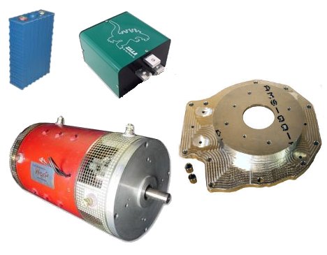

Here are a few of the key components, in the attached pic there is Lithium batter, I will be fitting 48 of these 120AH cells into the back, where the fuel tank was and in the front. Altogether it will make up 156volts.
The green box is a controller which controls how much power goes to the motor. It can put out 1000 amps momentarily and something like 300 amps continuously.
Shown also is the adapter plate I was asking about originally, it bolts upto the motor and to the transmission bellhousing.
The motor is called a Netgain Warp9, the motor itself is manufactured by a company called Warfield and tuned for electric vehicles by Netgain. Its 9.25" in diameter. Its by no means the most powerful motor around, but people do use this motor in vehicles as large as utes like Couriers, or Chevy S10 trucks in the states. So it'll smoke tires on the MX5 for sure.
