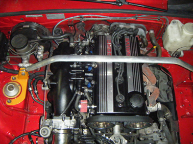

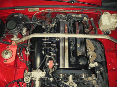

Post by sprsta » Tue Mar 17, 2009 8:16 pm
ok so here is the finished product

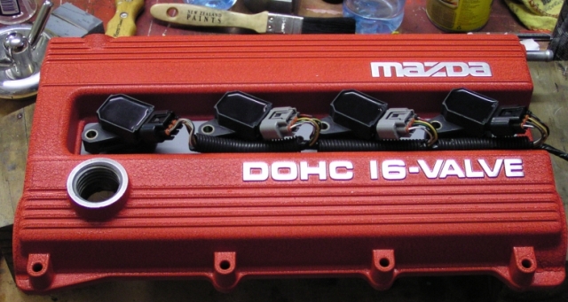

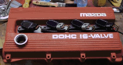

Looks good. I picked up an early cam cover off a 1.8 Astina and after cleaning it up have given it a coat of wrinkle red.
After pulling about a quarter of a kilo of stone chips out of my sump guard after Targa Bambina, I will be fitting the early plastic pulley cover as well. This gives easy access to the pulleys without having to remove the cam cover. It is actually all part of a series of developments which includes a coolant reroute. The early pulley cover will only fit if you get rid of the water outlet/thermostat housing at the front of the engine. But that is a whole other story.
I have a pic showing it on the bench with Toyota COPS in place, waiting to go on the head but can't seem to post attachments at the moment.

Post by Euen » Fri Apr 03, 2009 9:58 am
Lets see if this works. Pic is of the Astina cam cover with the Toyota coils sitting in place.
