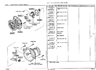

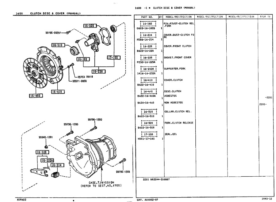

Post by jojonz » Wed May 16, 2007 9:48 pm
The new NTN thrust bearing is different than I have seen before.
Looks like it self-aligns, ie the bearing that contacts the pressure plate can move within the housing by about 4 or 5 mm.
The inside of the bellhousing was caked in transmission oil, from a transmission front cover gasket failure.
The gasket is a very thin paper? type, was wondering if I can substitute silicone or hylomar.
